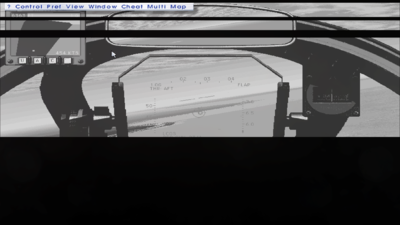

Deffnator wrote:
wile everyone is been testing new stuff
DI Apache Longbow 95(windows) and HIND has Flickering Menus and window problems
i didn't tested with the 3dfx patch due to the setup being busted, and the game patch being incompatible with modern windows
NVM, tested it with the 3dfx patch and Voodoo
3dfx patch has a perpetual black screen menu that it doesnt load after the cinematic intro
Voodoo2 works, but the cameras are busted and you cant change it.
The Game runs well without both + Using D3DRM.dll but its unstable and it crashes if i use it to change resolution.
as for Jane's FA
816.68 KiB
1852 views
this is what happens if i use menus and such
