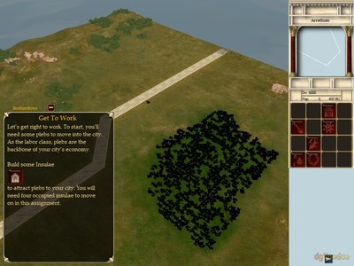

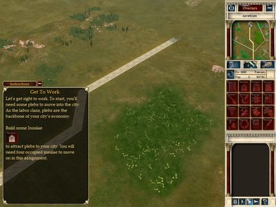

Reply 680 of 1111, by ZellSF
Caesar IV (GoG)
dgVoodoo:
127.15 KiB
2533 views
Native:
134.84 KiB
2533 views

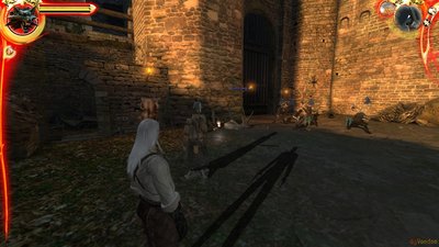

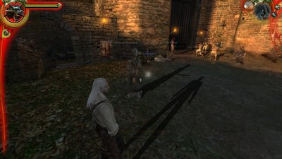

The Witcher
dgVoodoo:
742.43 KiB
2510 views
Native:
647.84 KiB
2510 views
Rendering issues, UI colors wrong, framerate less than 1 frame per second.

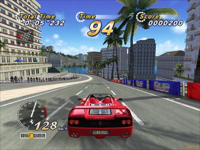

Reply 683 of 1111, by ZellSF
willow wrote:
Outrun 2006 coast to coast doesn't work. It refuses to launched. https://i.ibb.co/4Vh6YLx/Sans-titre.jpg […]
Disable antialiasing in Config.exe (ingame antialiasing settings seems to be problematic for quite a few games). If that doesn't work edit dgVoodoo.conf to limit resolutions:
DefaultEnumeratedResolutions = none
ExtraEnumeratedResolutions = 640x480
EnumeratedResolutionBitdepths = all
680.89 KiB
2506 views

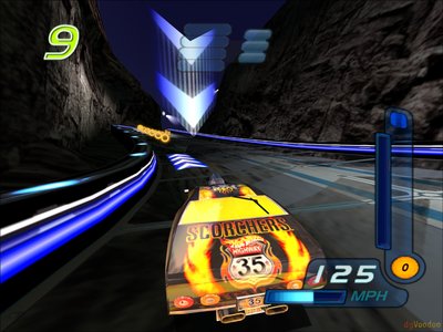

Reply 695 of 1111, by ZellSF
Hot Wheels: World Race
Seems ok (resolution forcing and all) for the one track I tried. Froze in fullscreen, had to run in windowed mode.
373.3 KiB
2246 views
