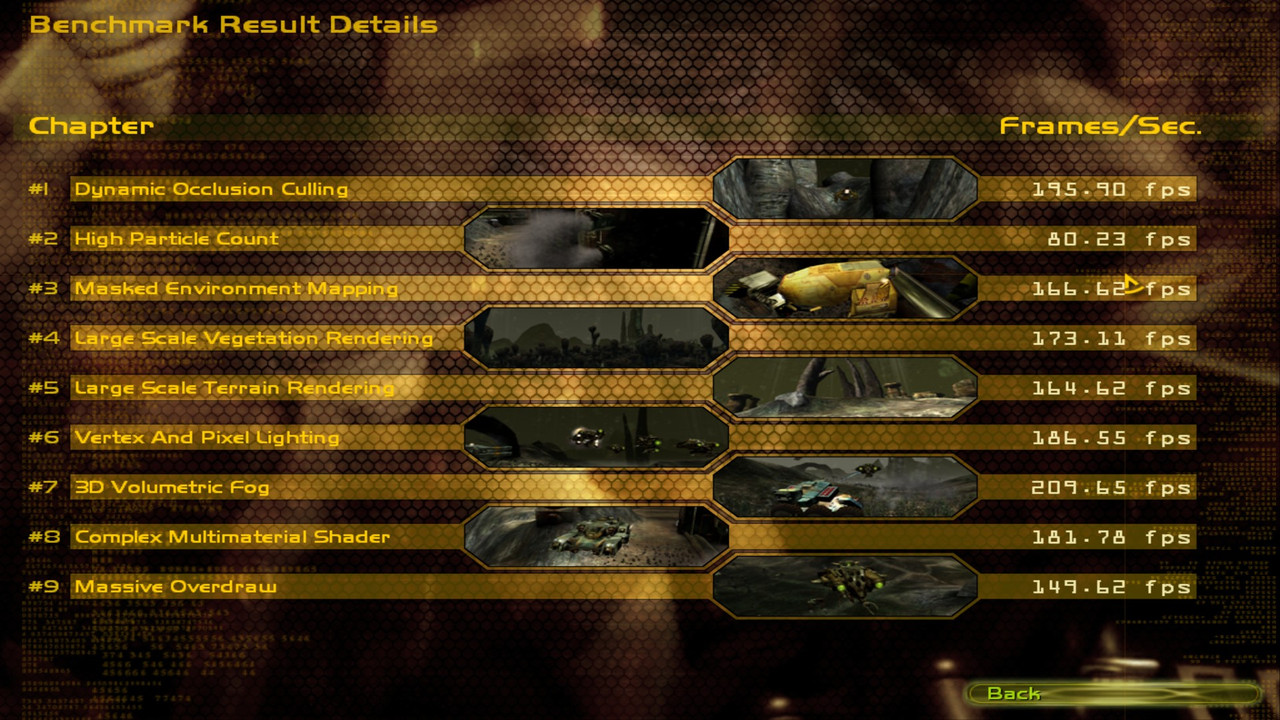

lowenz wrote:
Benchmark in Aquamark 3 (B3D9 tweak + nvidia game profile removed from the game/application profiles DB / application name modif […]
Benchmark in Aquamark 3 (B3D9 tweak + nvidia game profile removed from the game/application profiles DB / application name modified)
dgVoodoo2:
Updated results (new drivers, new WIP)

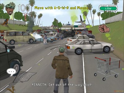

Bad Day L.A works great with resolution forcing, the list of resolution locked games is getting increasingly shorter.
655.46 KiB
2777 views

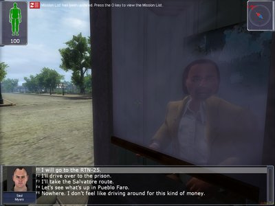

Boiling Point: Road to Hell works with resolution forcing and it helps a lot with UI scaling. Just make sure Windows DPI scaling doesn't try to get involved with the text. FMVs still don't work.
601.82 KiB
2777 views

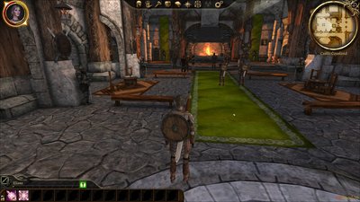

Dragon Age: Origins goes ingame know, pretty sure you knew that. Resolution forcing gives mouse issues. Also looks really ugly, but that's just because no shader model 3.0.
751.05 KiB
2777 views

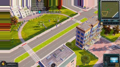

Didn't think Red Alert 3 would work, but it sort of does , except this glitch that doesn't seem to be a shader fallback issue:
646.05 KiB
2777 views

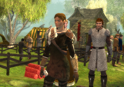

Neverwinter Nights 2 (Dx9) Working with latest WIP
    482.82 KiB
    2502 views
