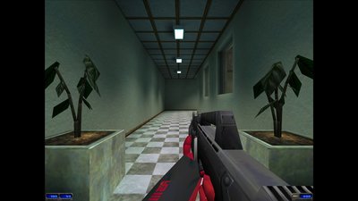

When using any of the "keep Aspect Ratio" or "4:3 Aspect Ratio" scaling modes in WIP69, there is a diagonal seam between the bottom-left and top-right corners of the screen.
Affects all games I've tried, DirectX and Glide.
662.96 KiB
2728 views
(top-left half is shifted down and to the right by 1 pixel, bottom-right half is shifted down 1 pixel)
This was not present in v2.62.3:

When using any of the "keep Aspect Ratio" or "4:3 Aspect Ratio" scaling modes in WIP69, there is a diagonal seam between the bottom-left and top-right corners of the screen.Affects all games I've tried, DirectX and Glide.
Nice catch, thanks! I can reproduce it. The strange thing is, the glitch shouldn't appear, as it doesn't do with the WARP rasterizer. It seems to be an nVidia-specific problem that I already encountered some years ago when working on ddraw-blitting. Anyway, I workarounded it, will be fixed in the next release.

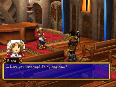

Wanted to play Grandia again, trying to find the best version to play I checked how the original 2000 PC release runs with dgVoodoo:
488.04 KiB
2513 views
Works great with forced resolution and antialiasing. Texture filtering isn't so good for the UI.
It isn't the best version if you're wondering. There is no best version, all of them are problematic. I would say the HD Remaster is the worst version though.
