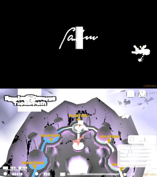

Gurumin: A Monstrous Adventure [DirectX 9]
Almost all textures and the menu are turned white/mono color.Fast video memory access does not fix the problem.Max res. in the game is 1980x1020.
334.3 KiB

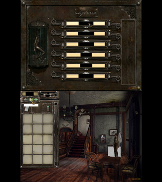

Syberia [DirectX 7]
Some textures which are related to subtitles or letters on the menu do not work properly and turned black/white.Fast video memory access only works for a white-turned backgrounds and menu problem.
FYI:Vanilla has some scaling issues.
1.73 MiB

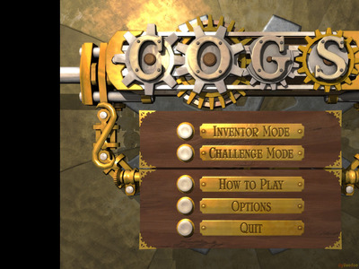

Cogs [DirectX 9]
Game screen slides toward right edge of the screen when fullscreen.A cursor also shows righter than an actual hit point.
Full screen/windows appearance setting won't work even I checked off Application controlled fullcreen/window state.Also scaling in Direct X won't work.
(added 2020/06/11)
I don't know why but now the game is running with extremely lower fps around 5 fps.Now a cursor shows same place as an actual hit point though.
794.84 KiB
2554 views
