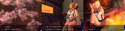

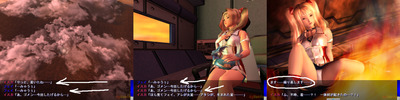

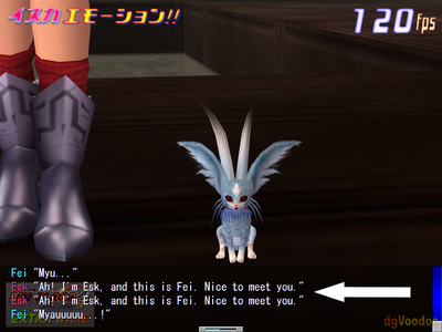

Now, when I was trying to translate one of these older games, DES BLOOD4 specifically, I ran into another problem, where when using dgVoodoo, lines of text gets duplicated for no reason, or some random lines appear out of nowhere. Attached are two combined screenshots to show the problem:
The attachment Expected behavior.jpg is no longer available
The attachment dgVoodoo.jpg is no longer available
I have literally tried changing all the (advanced) options in dgVoodoo, but nothing has fixed it. Once translated, it's really distracting to see duplicated lines almost everywhere. It's the only thing failing in this game, everything else looks as it should (the game is full of rendering errors without dgVoodoo).
Any ideas what could be causing this?

Hm, it's interesting. Could I get this game with your translated texts to look into it?

Thanks, 30 MB is a much more easy load than 3GB. 😃
I fixed it, the next patch version will include it. It's a pity you're not on Win10, the game works with that and the text scrolling issue is not present with D3D12.

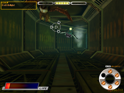

Thanks! That issue is resolved... but I found another one; it's not as serious as the text one, and you'll need the full game to see it... so I'll just leave this info here for reference if you ever feel like fixing it: the enemies names when fighting them overlap each other, and they remain "glued" together for the lenght of the encounter.
The expected behavior is: when you hover the mouse over an enemy, their name will be displayed on the upper-left corner of the screen; when you hover off of them, the name box dissapears. If you hover over another enemy, the box pops-up again now displaying their name, and so on when you switch between different enemies.
The currect behavior is: once you hover over an enemy, everything seems to be working fine, but in reality their name gets stuck there permanently. When you hover over another enemy, it gets "pasted" over the previous one, making them both appear at the same time.
This screenshot shows "Birdie Wood" and "Fish Dough" glued together.

Ok, so I'll need the complete game after all. Could you share it somehow, and I'll have a look at it soon?

Thanks, I fixed the bug for DB4. Until the next WIP, you can enable DirectX\FastVideoMemoryAccess, the bug doesn't occur with that code path.
