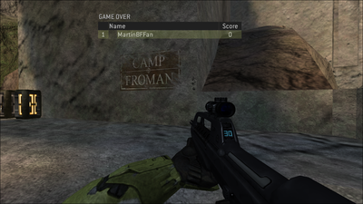

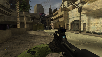

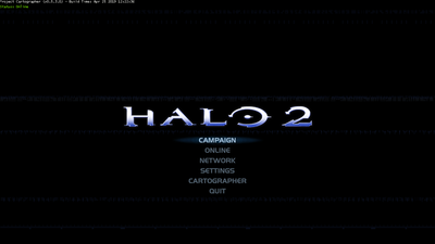

Reply 1 of 33, by MartinBFFan
Halo 2 Vista
DX9
Certain screen effects such as Color grading in main menu or cinematic black bars appear completely black
The game sometimes crashes on level load
Some HUD and UI elements are missing
Reply 2 of 33, by Dege
MartinBFFan wrote:
Halo 2 Vista DX9 […]
Halo 2 Vista
DX9
Unfortunately this game utilizes some parts of DX9 (through DXVA) that has no direct counterparts in DX11 so I cannot implement it.
I'll look at HUD and UI elements though.

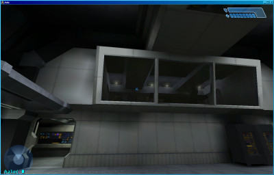

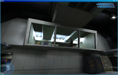

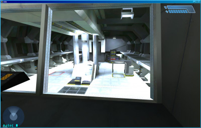

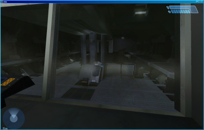

I have spotted another issue, this window on the first level is broken. Things behind it are much brighter than they should be. See attached images. This window does not use the games "glass" shader by the way.

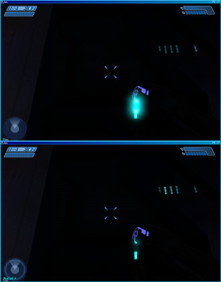

Also The glow on some weapons seem off, it is too bright. Lower is intended in attached image.
Thanks for working on this.
This has been in all recent versions of dgVoodoo2.

Nvidia GTX 1080, but It seems to be version of the map I am using. I just tested the stock one and it looks correct as your image.
What version of the game are you using? I can give you a map with the shader that is broken.
