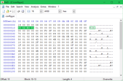

Seems resolution forcing isn't needed as if you edit config.pc it will happily set a 4K resolution (though who knows, it might crash later):

And how to force the resolution to be changed in the config.pc file? I can't read it in the notepad, and in the hex editor I don't see any hex values ​​that match the set resolution

Do you have a different config.pc than me or can't you read hex?
49.16 KiB
1799 views
E0 01 = 480
80 02 = 640
https://www.wsgf.org/article/hex-editing-tuto … mcity-4-example
https://www.wsgf.org/article/common-hex-values
Also remember UAC file virtualization, if you have the game installed in a location you don't have write access to, config.pc will be written to VirtualStore, so the one in the game folder won't have the value you set.
