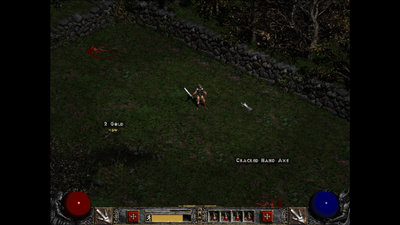

also could someone test Diablo 2 with the glide DLL's, the game itself is glitching even with default settings
F*ck, Glide3.dll was damaged in dgVoodoo2_72.zip... I fixed it and Diablo2 works as before.
I reuploaded dgVoodoo2_72.zip both to my site and GitHub.
Also, fixed the links as well.

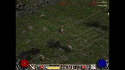

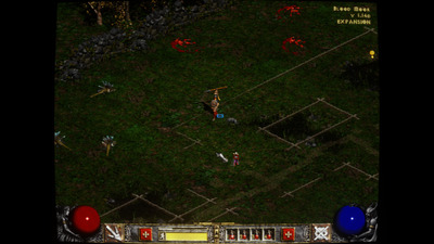

it still has artifact issues after playing for a while, ddraw has none even with reshade in it

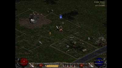

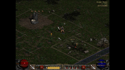

Reply 316 of 474, by Deffnator
lowenz wrote on 2020-12-17, 15:42:
Deffnator wrote on 2020-12-17, 01:54:

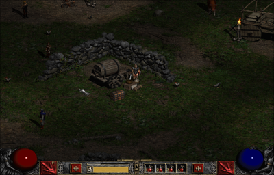

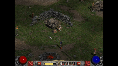

1.14D and Glide?
Other Glide wrappers results?
No issues at all using Sven's wrapper

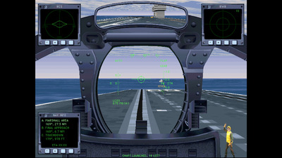

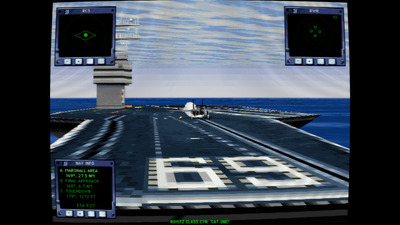

as a Side note i came to test jane's FA again
Unforced Resolution + SVGA card seems to fix the game's black flickering issues along with some changes that i did out of nowhere on the cfg file
I cannot reproduce it on my machine. What about earlier dgVoodoo versions? I didn't touch anything in Glide in 2.72 that could produce such artifacts.
Or, is it tied to a specific location in the game?
Using the default english version of the game 1.14d
i've tested it again with a fresh copy of 1.14d, it has some image scaling issues with both napalm and stock glide3x.dll and all configurations
1.46 MiB
1939 views
1.81 MiB
1939 views
with Sven's wrapper Glide3x.dll everything works perfectly
553.38 KiB
1939 views
560.81 KiB
1939 views
