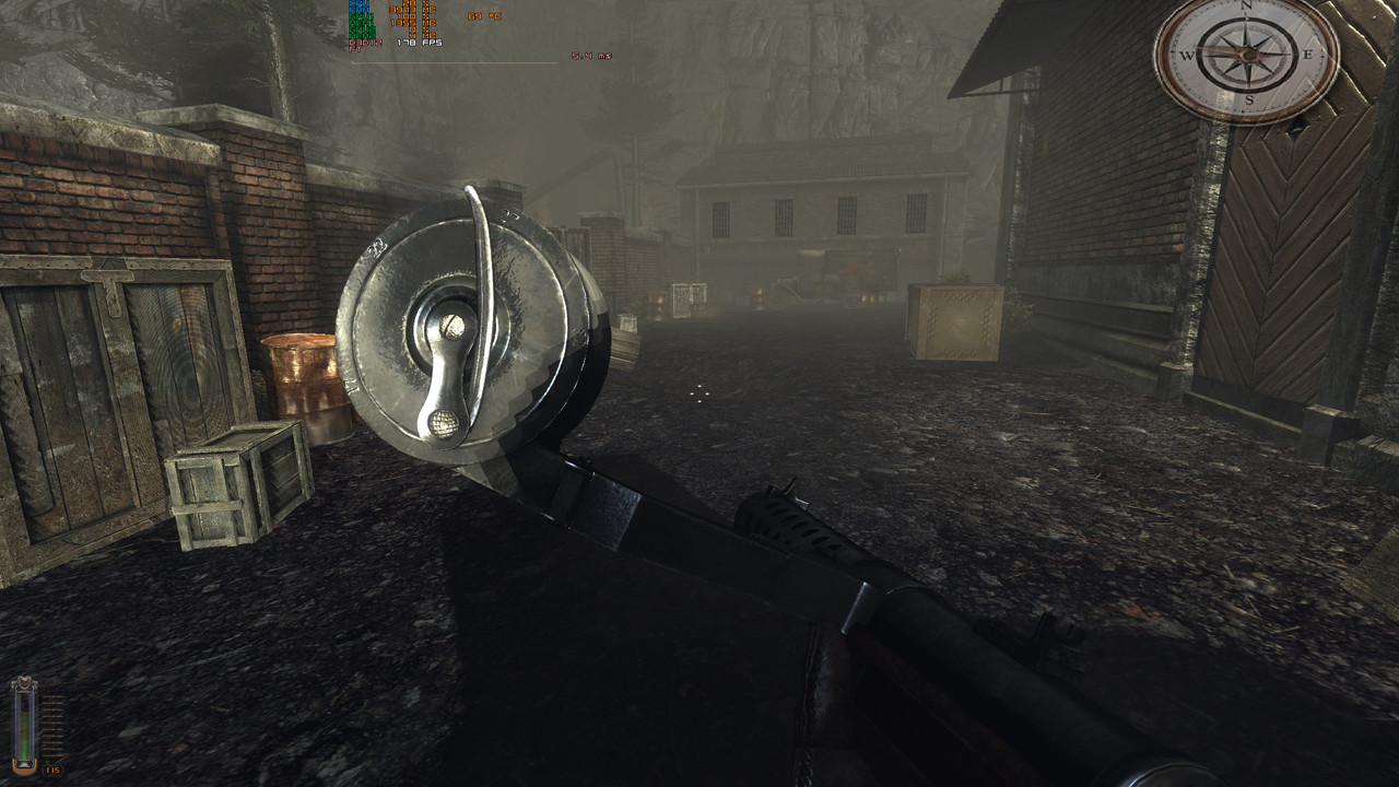

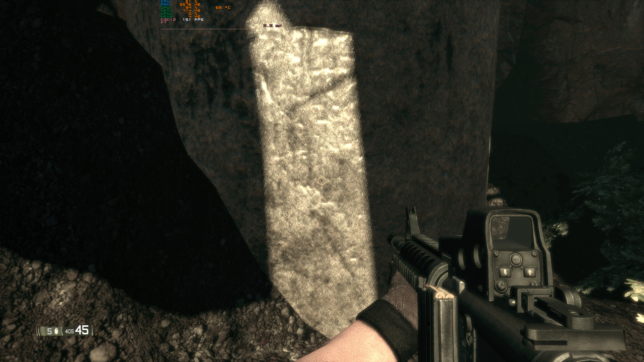

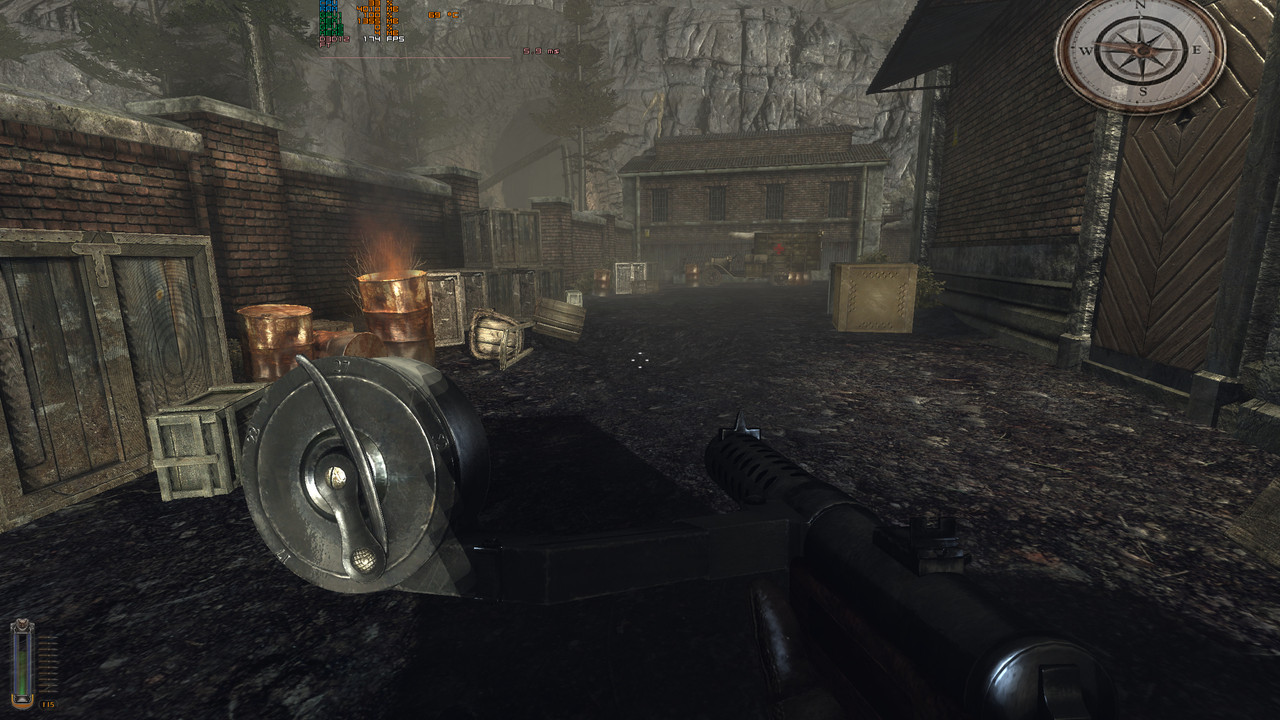

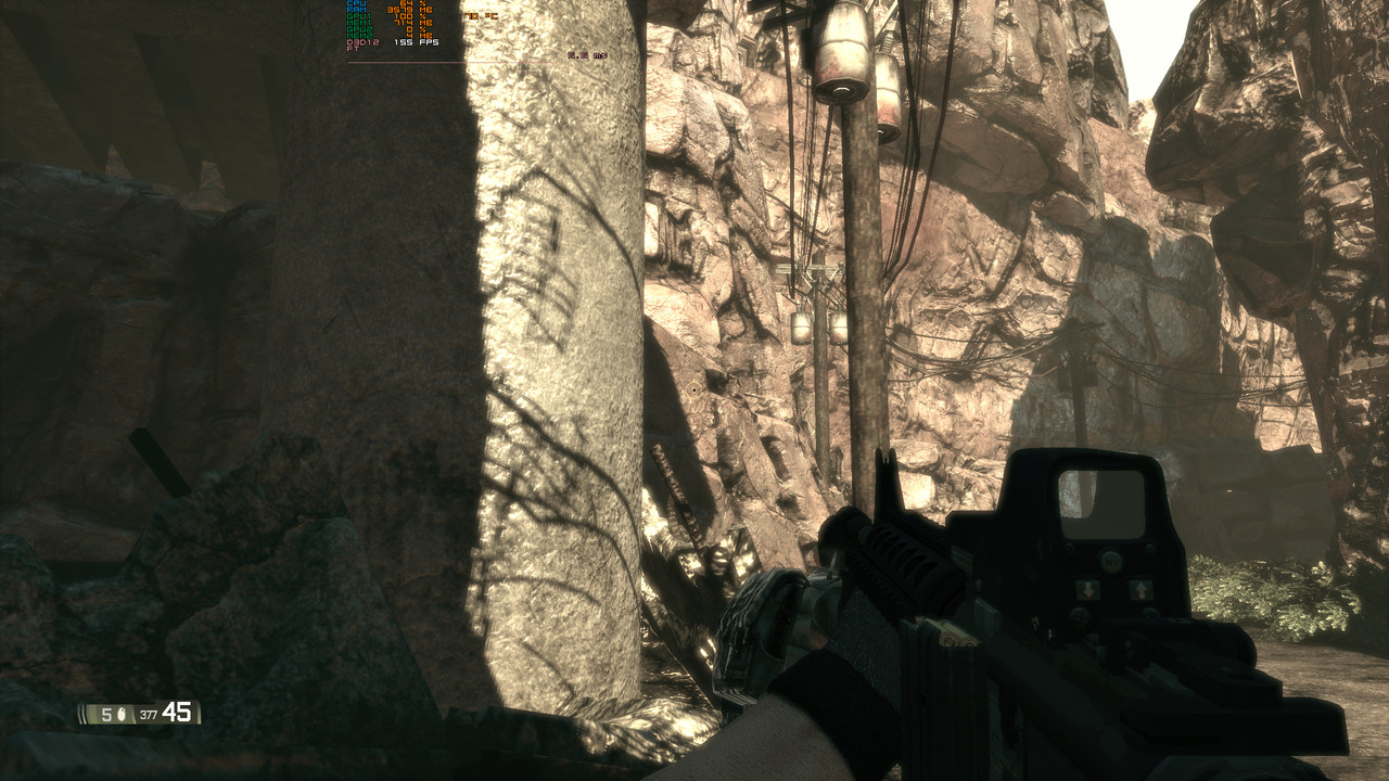

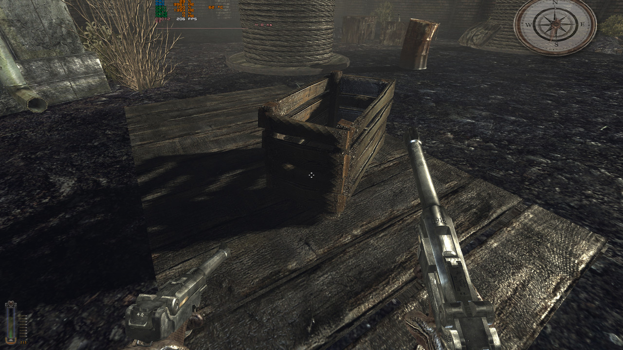

Question: is it possible to fix blocky shadows artifacts in "pathological" D3D9 titles like Necrovision series or Blacksite: Area 51 like it was done with D3D8 and Splinter Cell 1/2 ?
Maybe some people here may remember some other games having those artifacts (due to the shadowing technique ?)

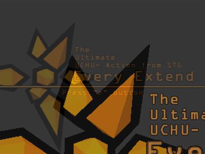

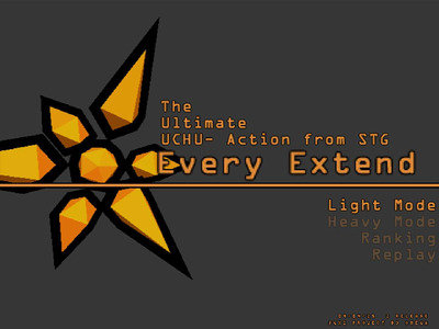

Reply 378 of 474, by ZellSF
CRT filter + integer scale + lanczos:
101.89 KiB
1877 views
CRT filter + integer scale + bilinear:
108.88 KiB
1877 views
Not important (I don't actually use these settings), but this seems to be a bug.
