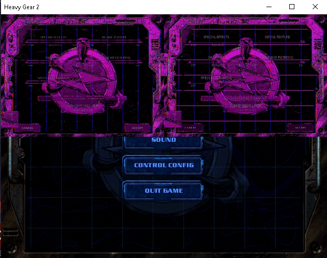

Heavy Gear 2 seems to not like D3D12 wrapper (maybe it's the intro video?). Can you check Dege? I got crashes/freezes at start. […]
D3D11 working, still the video options menu corruption is present:
We were talking about this game previously, I cannot remember what the solution was. I tried it, works flawlessly for me with D3D12, and the menu screen looks normal as well.
Different version of the game we're using? (I don't know if I applied a patch or sg)

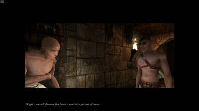

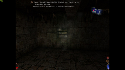

Tried Arx Fatalis with latest dgvoodoo and forced resolution (because game does not support UI scaling on high resolutions) - and got some big framedrops from 60fps, especially when opening inventory or looking at some light shafts (gpu usage is at 40% or lower, strange). Also some some game models have black outlines around ears, i fixed this by switching from DX12 to DX11.

Reply 65 of 474, by Dege
There is no difference between D3D11 and D3D12. You can use GeForce4 Ti4800 card type to have 'full cut' colorkeying to make unblended black edges disappear.
Performance drop: unfortunately this game frequently use DDSurface::GetDC/ReleaseDC methods to access bitmap data by the CPU. It's the least efficient way, even fast vidmem access doesn't help.
What is more, it even makes things worse. At least now I improved it to bring it on par with no-fastvidmem case.

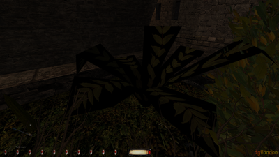

Some bugs I encountered are in NFS:High Stakes shadows are glitched and in Thief 2 some of the transparent textures are not transparent and have a black background. No screenshots for now.

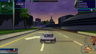

Reply 72 of 474, by therealdadbeard
Here are the screenshots from NFS4 and Thief2. Both of those issues are not prevalent on 2.64.
Reply 73 of 474, by Dege
I fixed Thief 2 (I wonder why it works with 2.6.x 😁) but as for NFS4, what car and what renderer (glide, d3d) are you using? I cannot reproduce it.

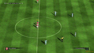

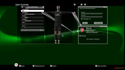

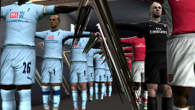

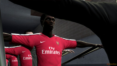

Hello, wanted to know if there's any way DGVoodoo can fix the bug that is plaguing FIFA 09 and FIFA Manager game that uses FIFA 09 engine, basically, the game will fail to load players animations causing them to be stuck in a t-pose with a melted fingers, i tried with WIP 75.1 and earlier versions that supports DX9, but no luck trying to run there, so thought would be nice to ask if it's possible to get it fixed with DGVoodoo wrapper.

Dege wrote on 2020-08-10, 18:42:
Edit: Ok, it must be some of the D3D's because of the watermark. But which one?
Yeah I'm stupid I thought my modded version would behave the same. I can't repro it to on my vanilla NFS howewer forcing MSAA is way blurrier for whatever reason on the WIP version. This is with the DX7 from the beta from the modern patch that is available. Í have no idea which car exactly my modded one is but I'm pretty sure it is this one https://www.nfscars.net/need-for-speed-high-s … iles/view/5849/ and this is the modded track https://www.nfsaddons.com/downloads/nfshs/tra … ica-hi-res.html

Maarcis12 wrote on 2020-08-11, 22:08:
That's hilarious.
Reply 78 of 474, by Maarcis12
lowenz wrote on 2020-08-12, 09:56:
Animation problem -> CPU
would make sense, but that only happened when i swapped my videocards. It was working fine on my GTX 950 2 GB MSi Gaming card, but when i swapped my card with 1050Ti Zotac OC edition then game started to exhibit this bug. I even tested on my laptop, it's working fine there. So i doubt that's a issue with CPU.
