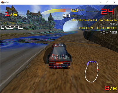

As the title said, here's the sample. Other glide wrappers are fine, tested OpenGlide, psVoodoo and nGlide.
The dgVoodoo2 version is 2.72.
The demo does not have the issue.

Running through QEmu?
Running it natively I don't get those glitches, but I must admit:
- I cannot play this game. 😀 Switching gears by Q/W works but accelerating is not. My car is rolling so slow that I get a race timeout after the first 10m. Maybe the glitches is tied to a later point of the level.

Reply 2 of 7, by kjliew
Yes, I was running the game through QEMU.
How did you get it run natively? Was it on Windows 10? It didn't work for me at all on Windows 10.
The rendering corruption (blueish tint) happened right at the start even during count down. It then slowly faded for close-up scenes but remained at distant. Seemed like fogging discoloration or mip-mapping issues.
Other glide wrappers are fine, so I didn't expect this is QEMU issue. Did you actually patch it to 1.50? You could tell that if you get the option to go 800x600. Otherwise, the game played perfectly on QEMU, a little too fast without v-sync (over 120 FPS, all details max'ed, full shadows) and almost constant 60 FPS with v-sync.

I checked it out: the executable is of version 1.50.0.0, and no matter what resolution (640x480 or 800x600) I choose for Glide, it works as expected (only D3D11 with dgv 2.72).
Btw, it seems to be a mipmapping issue definitely.
Update: maybe a difference between 32 bit vs 64 bit builds of the glide dlls.

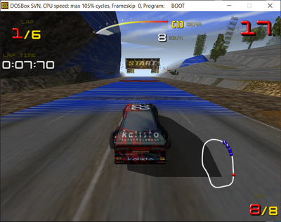

Same issue with DOSBox SVN 4393 64-bit compile.
426.98 KiB
308 views
URP150-disbox
