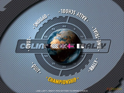

Dege: you might want to look into the game. There's some texture errors here and there:
88.42 KiB
1616 views
Flags are obviously wrongly colored, I haven't been able to display them properly in any scenario, but I'm pretty sure that's a bug with dgVoodoo (or maybe the game just checking color depth and doing some dumb conversion of its own).

Thankyou! It was the W7 patch that I was missing. Once I installed that and turned off the compatibility modes, the game runs smoothly (albeit with messed up colors in the menus, as you've noted).
Implying the messed up colors weren't there before? Interesting, you're right. The Win7 patch is what messes up colors. Never mind that then Dege.
