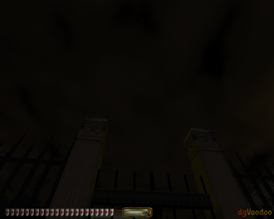

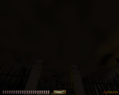

Dege wrote on 2022-07-12, 12:02:Thief2 Metal Age? I have a version with a D3D9 renderer but I can't see any difference between 2.77 and 2.79. Do you have the original version (D3D7 or sg like that) of the game?
Yes I am using the D3D7 version of the game on Windows 11. The screenshots show the missing stars in the sky.
v2.05.77
v2.05.79
I installed the original version of the game (version 1.07 I think) but the sky texture was there with 2.79. The game could be patched to 1.18 if I got it right but anything else higher is D3D9(?).
Dege wrote on 2022-07-13, 12:06:I installed the original version of the game (version 1.07 I think) but the sky texture was there with 2.79. The game could be patched to 1.18 if I got it right but anything else higher is D3D9(?).
I use 1.18 as well, the newer versions are newer engines so they change the architecture.
The stars appeared why the Sky Detail was set to low, it appeared very blurry.
