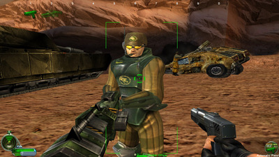

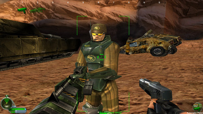

KainXVIII wrote on 2021-09-12, 13:52:
nX3NTY wrote on 2021-09-12, 07:25:
Hello guys, I registered just to say thanks for making wrapper for Truform. I been waiting for a long time for someone made this a reality. I tested a couple of games Serious Sam TSE and C&C renegade, both works well with the wrapper! Performance is great with GTX 1070 at 1080p
I really can't see the difference in C&C Renegade with Curved Surfaces setting on/off (or its just not working).
For C&C Renegade you need to adjust it in the registry. Look for 'NPatches_Gap_Filling_Mode' and subsequent 'Npatches' value. Change it to 1. I forgot which one forcing it to higher level, I think Npatches control the value of tessellation where 1 is 2x, 2 is 4x 3 is 6x, while NPatches_Gap_Filling_Mode where 0 is off, 1 is on, 2 is Forced on. Just put value 2 on both so you get optimal result

Reply 41 of 61, by KainXVIII
nX3NTY wrote on 2021-09-22, 13:50:
Oh, thanks!

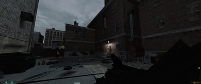

So far I had not much luck in forcing NPatches, the only game that reacted in any way is FEAR, but there is no smoothing, only artifacts 😜

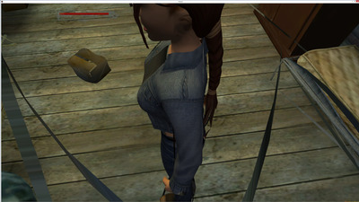

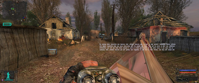

Reply 47 of 61, by WSH303
Stalker in DX8 mode. Looks like you were right about it 😁 I will try to find something that works correctly, but so far no luck 😜
    1.35 MiB
    1469 views

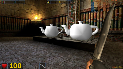

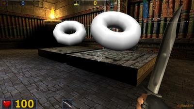

Reply 49 of 61, by nX3NTY
Serious Sam TSE was the easiest game to test for Truform on or off because it have its own technology demo. The last room shows model with and without truform. It can even force all models to do truform but artifacts will occur on some models like trees, vegetation etc. Serious Engine is one fun game engine that supports most, if not all, supported technologies of the time (like triple texturing which unique to original Radeon)
    329.32 KiB
    1416 views
    291.31 KiB
    1416 views

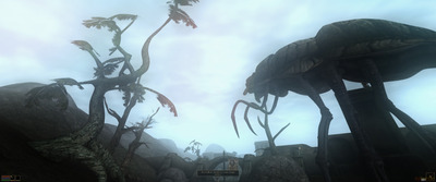

But Morrowind... I wish TruForm was implemented in wider amount of games, and that ATI didn't abandoned it.
Btw. I checked FEAR again, and it seems forcing TruForm is working after all. It generates huge amount artifacts, flying triangles everywhere, but one object type is smooth - garbage bags. Garbage bags are almost photo realistic now 😁
Reply 51 of 61, by Dege
Very nice!
Btw, I looked into Stalker DX8 mode, and found that vertex shaders of the distorted polygons uses incoming texture coordinate as integer indices into the shader constant buffer (for vertex 'animation').
So that, texture coordinates are not texture coordinates but integer indices.
This is the equivalent of BLENDINDICES of the fixed function vertex pipeline, that's mentioned in both the DX SDK and the ATI Truform docs that it's not compatible with the technology because indices cannot be interpolated across the triangle in any meaningful way (obviously).
Summarized: in this case TruForm is forced to a shader incompatible with TruForm. It can easily be the same situation with FEAR, vertex blending based on indexed matrices or weights is a very common technology for mesh animation.
This technology was advertised in the docs as one that's compatible with traditional meshes containing normal vectors, very easy to use without the need of re-designing existing meshes, unlike with RT-patches, requiring additional information (in fact, the control points).
So, no code and mesh modification is needed, you just enable the feature through the DX API and it automatically/magicallly works.
Well, it's just partially true. Meshes contain shared vertex positions and normals for neighbour triangles, so, for keeping cornered parts of the mesh cornered, it needs to be modified not to use shared vertices for that part.
Or else you get strange things like crates pumped into a stuffed pillow. 😁
So, this technology has it own curse, maybe that's the reason not many games supported it. Or the real time performance. I didn't have the ATI hw back in the day so I myself don't have experience about how well it performed but what I read about it it wasn't stellar.

Morrowind 2021-10-10 20-31-48.jpg File size679.92 KiBViews33 views
oh my god its very beautiful , unbelievable.
