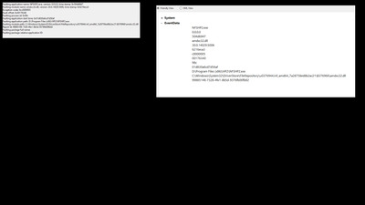

Reply 9 of 25, by Ravagino
Hello.
since a few months i can't start any more games with dgvoodoo2 if i use a current AMD GPU driver.
the last working driver is 21.5.2.. but i always have to reinstall this after 1-2 days if i want to play games with dgvodoo2. it seems to me that something is updating itself even though i have disabled windows driver updates.
newer drivers do not work from the start. my system: AMD RX 5700 with Windows 10 home.
I always use the DX12 API because the older ones never worked with my GPU without graphics issues.
I'll show you a few screenshots from the event viewer.
I also upload the dbug log.
I hope that someone has a tip how I can solve this problem.
