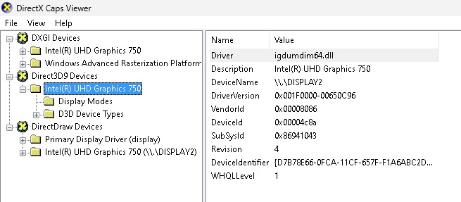

Thanks for providing that screenshot! Huh, it would seem that some 11th gen iGPUs has the native driver while others do not.
Maybe it’s related to the specific iGPU they have? 🤔
Reply 22 of 32, by lowenz
It's related to the GPU ID so you can just mod the drivers package installer (and get it signed)......

lowenz wrote on 2022-08-17, 22:07:I can confirm that the 11th gen Intel GPU loads the *NATIVE* d3d9 driver. […]
Log: Bound to D3D9Drv.dll
Log: Initializing D3D9Drv...
Log: D3D adapter driver : igdumdim64.dll
Log: D3D adapter description : Intel(R) UHD Graphics 750
Log: D3D adapter id : 0x8086:0x4C8AUsing d3d9on12 the driver is another one.
Log: D3D adapter driver : igd10iumd64.dll
Which tool were used to capture this log btw? I could use a tool that as efficiently and easily told me the adapter driver in use.
Reply 25 of 32, by lowenz
Just Unreal, it does (writes) the initialization log since 1998 😁
Ah, just connect a physical monitor to the iGPU if you want to be sure about D3D9/DDraw support. Maybe it's needed.

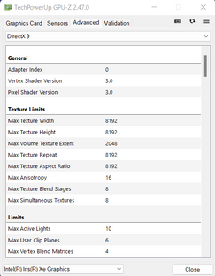

Reply 29 of 32, by rml_br
Tried Resident Evil 5 Demo DX9 with native Intel DX9 vs Dgvoodoo (v2.79.2, default settings) on "Fixed Benchmark"
58,2 FPS Native DX9
52,2 FPS Dgvoodoo2
