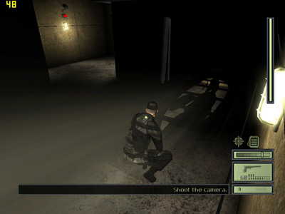

I seem to remember that in your videos, there were still some shadow issues with the Geforce 4, when compared to the Xbox version.
Here's how it should look like (on Xbox):
Taken from here, just after 10 minutes: https://www.youtube.com/watch?v=JriSe12tzd8
From what i remember, in your walkthroughs, the wooden plank section behind the pole didn't have the lighting on correctly. I could be wrong as i cannot check since you seem to have removed your videos but i seem to remember it looking odd at the time.

Are you sure it had the shadows on the vertical plank? From what i remember of your let's play video it had them on the horizontal ones behind it, but on the vertical plank behind the pipe, all the lighting was not there.
Ok I found the video, and you are correct!
This is at 104 x 768 resolution:
In the video you linked, in the description:
Framerate is slightly lower than normal due to it being played on a 360
I've also checked out this spot in the PS3 HD version, it also displays the shadows like on the XBox version.
I might revisit this and try this spot with a few cards and different driver versions.

It is missing the light rays from the blinds in the cutscene but adds in light on the wooden planks where you crawl under the netting on the assault course. This doesn't appear to be in the xbox version - at least from the video above but DOES appear in the pc one, at least from what i can tell from my broken shadow buffers running on a newish laptop. Incidently, they flicker in and out depending on distance and mouse movement on pc much like they are appearing to do in the video on ps3. I'm not actually sure if they're meant to be there or not and whether the xbox is "correct" as you are kind of down in a pit in that area and you woudlnt have thought the light beams would get down that low. Mind you, it's artistic direction, it's not like they're simulating the light coming in from the windows haha.
It just makes you wonder if all versions are half broken. Or maybe there really isn't meant to be lighting there and the xbox is correct.
Then, the ps3 one fixes the lighting behind the pole pictured above.

I tested this scene with my 'new' GF 4400 Ti. It's the same., Tried a lot of versions : 2x.xx to 9x.xx and it shows the same. It seems that the developers missed this one.

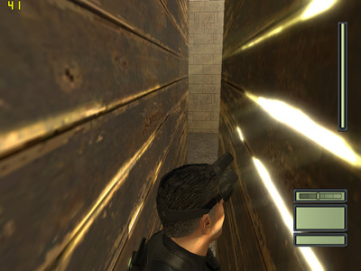

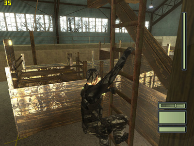

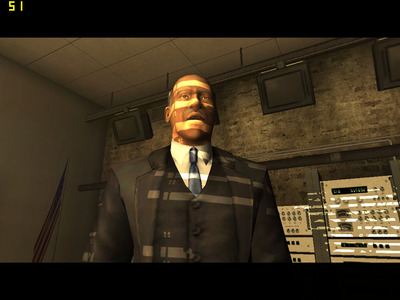

I fixed my old 6600 GT today (cooler had to be replaced) and decided to give the original Splinter Cell a whirl. For reference, I was using 77.77 WHQL drivers under WindowsXP SP3.
The game auto-detected shadow buffers and used them for rendering by default. I also forced them by editing SplinterCell.ini and setting ForceShadowMode=1 just to be sure. There were a few missing lights and shadows in certain places, such as when Lambert is walking towards his office during the intro. But on many occasions, the game does seem to use the high quality shadows, and consequently looks pretty good. I haven't done any extensive testing yet, just played through the tutorial mission, but I like what I've seen so far. Here are some screenshots:

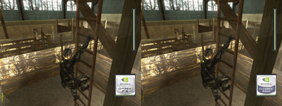

I did some more testing to compare the Shadow Buffer rendering of a GeForceFX 5700LE and a GeForce 6600 GT. In some cases, the high quality shadows are rendered exactly the same between the two cards. However, in certain scenes there are definitively shadows and light sources missing on the 6600 GT. Here are a few comparison screenshots:
471.21 KiB
732 views
This screen shows very few differences between the two cards. But if you take a closer look, you'll notice that a light source is missing on the 6600 GT. It's in the lower left corner, next to the yellow "X" marker.

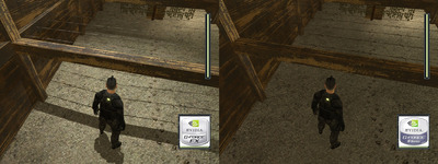

399.3 KiB
732 views
Here, the differences are much more prominent. The light illuminating the barbwire fence and the wooden beam is entirely absent on the 6600 GT, as are the shadows that it's supposed to cast.

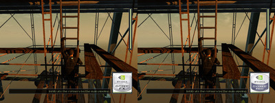

316.5 KiB
732 views
Notice how the metal fence doesn't cast any shadows on the 6600 GT.
