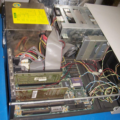

Reply 273 of 359, by Cuttoon
did not quite parse through all 14 pages of this, but should anyone be keen on the bios of this thing, let me know.
It's a Cyrix Cx486DLC ISA board with headland chipset. Box says "sunny".
Bios options surprised me in their scope and convenience.
I like jumpers.
Reply 274 of 359, by Anonymous Coward
It appears to be an Octek Jaguar IV DLC board. I believe those are pretty good. I think we might already have the BIOS from one of these, but I guess it wouldn't hurt to dump it anyway. Maybe it's a different revision.

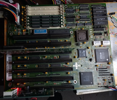

ETEQ IBM 486SLC2
Vendor: MR
Version: V1.61
String: ETEQ330
    1.04 MiB
    634 views
    486mb17224.BIN.zip
    42.05 KiB
    24 downloads
Reply 277 of 359, by Anonymous Coward
I'm pretty sure that board can be equipped with Cyrix SLC or IBM SLC.
Reply 278 of 359, by dataino.it

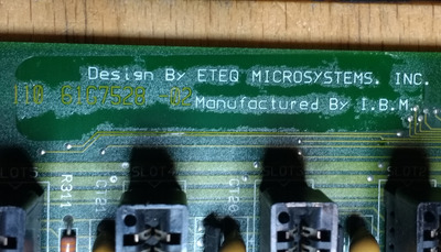

It is a ETEQ-IBM mobo
but surprise do not have a IBM CPU
https://www.ultimateretro.net/en/motherboards/2245
mt777 wrote on 2022-05-10, 12:50:
not IBM SLC2 😒 but still nice find
Reply 279 of 359, by Anonymous Coward
I think this board was made at a time when IBM was transitioning from Intel to Cyrix. It is kind of weird that a TI branded version was used though. IBM never sold the Cyrix based SLC under their name as far as I'm aware...and it would have been a confusing mess if they had.
