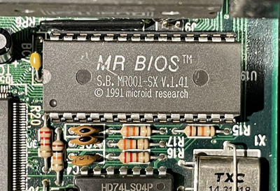

Cyrix200+ wrote on 2020-05-12, 11:43:
I noticed a 386SX motherboard on an auction site and asked the seller for a BIOS dump. He helped out 😀
I am not sure this one was already found before, the board has the Acer/ALi M1217 chip. BIOS ID is V1.41-ACER310.
I have a board exactly like this one, but it doesn't boot.
I'm going to try this bios available but this bios chip “Mr bios” doesn't work in my bios programmer TL866 ii (it doesn't appear in the chip listing).
Would anyone know please which chip I could be replacing this “Mr bios” (28 pin)?
I would really like to see this board showing a sign of life because it is the only 386 I own.
Reply 294 of 359, by keropi
EduardoHF wrote on 2022-09-30, 19:21:
I'm going to try this bios available but this bios chip “Mr bios” doesn't work in my bios programmer (it doesn't appear in the chip listing).
select a generic 27C512 chip and disable "chip ID" setting on programmer (or ignore the "ID not match" or similar error)
it will be read safely - this chip is just a "one time programmable" 27series rom with a custom label

Reply 295 of 359, by EduardoHF
Thank you for the tip!
I'm going to buy one of these and try it.
And is there any EEPROM option that I can use, because I don't have a UV eraser
Reply 296 of 359, by keropi
I thought your question was about how to read that "mr.bios" chip
I have no idea which bios data can replace that but it's guaranteed that a 27C512 eprom with the suitable data can replace the mr.bios chip

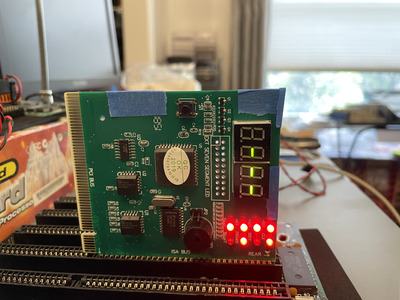

Reply 297 of 359, by EduardoHF
What I intend to do is write a new bios to see if my MB works.
On the analyzer the IRDY LED is off and the others are OK. No digits appear.
I have a hobby oscilloscope and I noticed that the address and date pins have some activity.
I think the only thing left for me to do is try a bios rewrite or a new bios chip.
If it's a chipset problem, there's nothing left to do.
