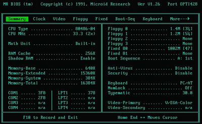

Reply 171 of 385, by root42
My new 486 board has a Microid Research BIOS. I will have a look at home which chipset it has and dump the BIOS, just in case. Wonderful that people are collecting the images now! I was so happy to see that the MR BIOS of this board supports HDDs (and therefore CF cards) larger than 504MiB!

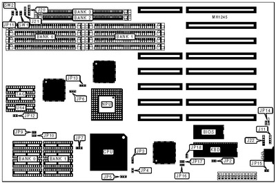

Reply 172 of 385, by root42
Here is the BIOS of my OPTI-82C493 (number on the chipset BIOS says OPTI-428) based 486 board. I think it's the board shown below, the CPU and SIMM slot arrangement fits exactly.
