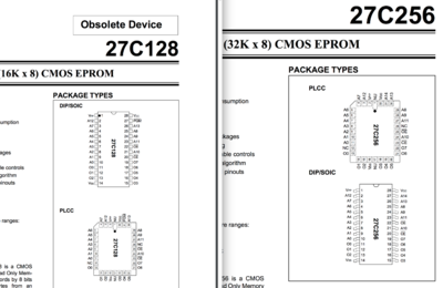

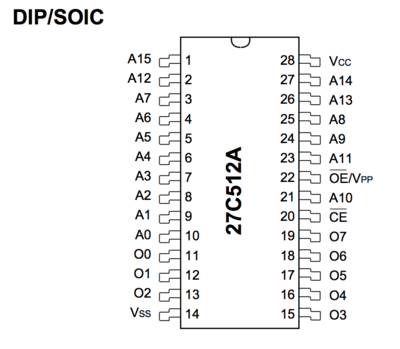

Thanks for the advice everyone. I will try dumping it again tonight as if it were a 28-pin 27c256:
166.08 KiB
2674 views
All these variants of the 28-pin!
84.49 KiB
2659 views

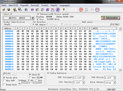

Reply 41 of 385, by keropi
^ better try as 27C512 and see if you get duplicate data (2x32kb data)
Reply 42 of 385, by Anonymous Coward
In my experience, almost all 386 BIOSes that use a single chip are the 512kbit variety.
Reply 44 of 385, by Anonymous Coward
yup

Here's the correct binary for the Forex 300 MR BIOS as a 27C512 (64kB as opposed to the 16kB)
45.83 KiB
2455 views
Just recently I got several other motherboards so I ordered a USB programmer.
