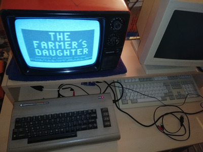

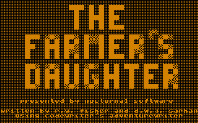

Edit: Ran the game on a real C64, too. Picture attached.
    272.22 KiB
    2239 views
    Real C64 (early version, PAL)
    1.29 MiB
    2508 views
    Hercules hardware emulation (OAK OTI 037c / VGA card)
    4.39 KiB
    2508 views
    Hercules software emulation (DOSBox v0.7x)

Jo22 wrote on 2021-09-03, 22:18:
The utility would also likely be helpful to find out incomplete HGC compatibility, as it was the case with DOSBox, see pictures below.
You're comparing the Hercules emulation of a VGA card with the Hercules emulation of DOSBox using a C64 emulation... 🤣
I'm not sure what's going on in those screenshots, but it looks like some kind of font issue -- not just the diagonal edge sections but the upper vs. lower case letters as well. In any case, I suspect some issue with the C64 emulator and not with Hercules graphics emulation.
Yesss, I did. 😅 The C64 emulator uses 640x400 mode, so I couldn't use it with a real HGC compatible ISA board - my TTL monitor simply refused to sync to that frequency.
That's why when I had taken the photo, I used a late 90s multi-sync CRT monitor and a period-correct VGA card instead.
I must admit, though, I haven't done further testing with Hercules hardware because of this.
Releasing magic smoke by playing with the fly-back transformer (on TTL/MDA monitors) was a popular sports back then, or so I heard. 😉
In the future, I'll do some more tests in other emulators, maybe the error happens there, too.
If you guys wish, I can also provide the image file of that text-adventure. It seems to be public domain/freeware, but I will double check.
The font seems to be software-rendered by the emulator itself, but I'm speaking under correction.
Unfortunately, the C64 emulator is a mystery in itself. Not even the author is known.
Edit: C64 had an upper-case/lower-case mode that could be selected by a key combo.
Maybe I accidentally triggered it, can't remember anymore.
The TITLE was drawn with glyphs/symbols from the stock PETSCI character set, I assume.

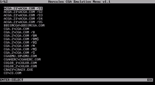

Well I sort of have a basic framework for loading all those emulators 😁
Its just a simple way to find out what the best emulator for each game is.
The goal: a list of every CGA game playable on HERCULES
This is what the tool looks like now:
1.85 MiB
2316 views
I'm making progress, but its going to take a while.
