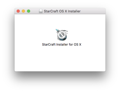

Reply 5 of 10, by leonardo
Srandista wrote:
YES! That's exactly what I was looking for! Only ... what now:
27.91 KiB
1757 views
Older versions of OS X only, I guess? 😵

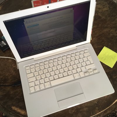

Yeah, it's starting to come back to me now. I just remember my friends and I gaming on different hardware, one friend having an early Unibody MacBook Pro. But those would have run OS X Leopard or Snow Leopard back then so I figured maybe the StarCraft OS X installer linked earlier only works on the earlier versions of OS X. I went digging and I found this old thing in the closet (by now it's too late, the LAN is over, but hey):
157.12 KiB
1710 views
It's a Core Duo, probably one of the first Intel MacBooks produced with 1 GB RAM. I put it away because it had some issues, like a dead battery, Bluetooth gone haywire and because it couldn't run an up-to-date OS. Now this is looking like a perfect StarCraft LAN-client...

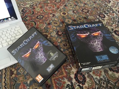

Reply 9 of 10, by leonardo
OK.

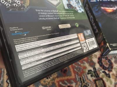

So for Macs up to OS X 10.6.8 the solution is this:
You need to get a later DVD-cased release of the game. In my case I found this one going for 7€ used. Not a bad deal. The box says you need WinXP, Vista or 7 - OR OS X 10.3.9 and later. The version of the game on disc is actually 1.15.2 which can be patched (with the patches from the earlier post above) to 1.16.1.
183.73 KiB
1620 views
268.07 KiB
1620 views
This brings all the clients running Win95/98 and OS X Leopard/Snow Leopard on the same plane for LAN.
This means all early Intel MacBooks.
If you're running anything later than Lion, this is not going to work, obviously. We may need to resort to WINE or something else to run the same client across all the generations of hardware from a Pentium with Win9x to a modern Win7 PC or a Mac with the latest OS.

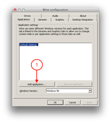

Double click WINE from your Applications folder, if it's not already running, then proceed with the following:
1) From the menu-bar on the top of the screen, choose Configuration. From the Configuration-window, select the Applications-tab and click on the 'Add application' button

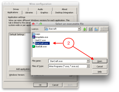

2) Navigate to StarCraft.exe and add it to the list of applications with separate configuration options:
72.52 KiB

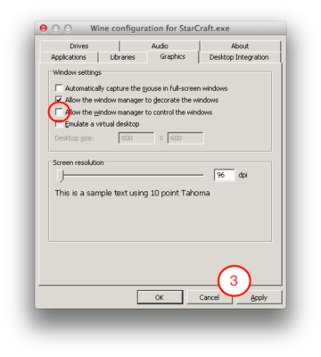

3) Now, make sure you're editing the settings for StarCraft.exe and move to the Graphics-tab. De-select 'Allow the window manager to control the windows' setting:
49.21 KiB

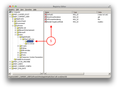

5) Navigate to the path HKEY_CURRENT_USER\Software\Wine\AppDefaults\StarCraft.exe using the pane on the left side of the Registry Editor. Then, create a new key underneath StarCraft.exe named Direct3D.
Inside the Direct3D-key, you need to create three new String values called DirectDrawRenderer, OffScreenRendering, and RenderTargetLockMode.
After creating the String values, right-click each and choose 'Modify' from the submenu to give them these values:
gdi (DirectDrawRenderer), fbo (OffScreenRendering), readtex (RenderTargetLockMode).
65.85 KiB
1503 views
After this, your copy of StarCraft / BroodWar will run glitch-free and smoothly and you can LAN-play with original hardware all the way down to first-gen Pentiums. 😎
