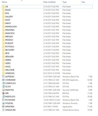

Reply 11 of 18, by Intel486dx33
Here is what is on the CD.
I want to boot off a DOS 6.21 boot disk and run a command to copy all the files to the hard-drive.
But I need the best way to do this without changing any of the original file directories and attribs.
What is the best way to do this ?

Reply 12 of 18, by Caluser2000
See above. That does not look like a recovery CD lay out just a copy of an fresh install copied straight over to a cd rom. As long as your current hdd has the same IBM Dos it's just a straight tranfer of all the files/folders. You can do this in an external usb hdd caddy on a modern machine if you want to.

Reply 17 of 18, by Intel486dx33
Okay, I used the following command “xcopy e:\*.* s/e/ c:”
That copied everything on the CDROM disk to the hard-drive including subdirectories and empty directories.
Worked great.
