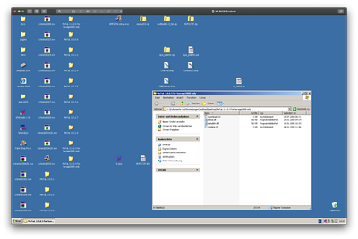

Reply 4 of 32, by CMB75
While scanning the virtual XP machine I set up a virtual Windows 98 SE machine ... unarchived the archive, run each and every included executable ... nothing "nuked" the system.
152.58 KiB
1109 views
Will run offline virus scanners over that system now, too.

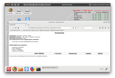

Reply 5 of 32, by CMB75
My preliminary conclusion:
I extracted the contents of the s3_metal.rar archive on a WinXP and a Win98SE machine. Both didn’t show any signs of being “nuked”. I deleted the self-extracting archives (probably the culprit here (false positive)) and left all the extracted files on the system.
I then used four different virus scanners with up-to-date virus definitions and heuristics on those drives. I could not find any prove of malicious code.
