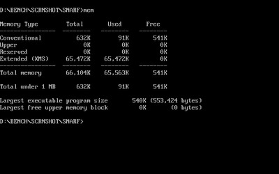

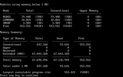

Reply 9 of 22, by Riikcakirds
Got back home, it is exactly 632KB of conventional memory, so 8kb is missing, not 9kb.
These are two screenshots, clean boot to DOS, the only thing running is SNARF, dos screen capture tsr that takes up 4K. I used it to take the pictures.

Reply 10 of 22, by OzzFan
Thank you for providing those screenshots. Run the Microsoft Diagnostics (MSD.EXE) and take a look at the memory map. Does it say anything is using the first 8K or the last 8K in the conventional memory area? Another tool that may be helpful if you can get it is the Quarterdeck Manifest diagnostics program (MFT.EXE), usually included with QEMM386.
