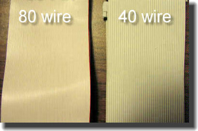

Are you using an 80 wire IDE cable? Have you tried swapping IDE cables to see if one is bad? Do you know the CD drive is good?
I ran a pass and it said it passed, no errors. Also my IDE cable is 80 wire I think. I didn't count them, but it's yellow and relatively flat, I'll assume it's 80. Apart from those 2 things, I'm just going to reset my BIOS to default and move forward. I don't know why it's laggy, everyone agrees it's not right, but nothing seems to fix it.
I'm leaning toward the 1GB stick was causing issues or there's a bad IDE cable or bad CD drive or worst of all a leaky capacitor somewhere.
Difference between 40 wire and 80 wire. You need the 80 wire to use the full bandwidth your IDE controller has, otherwise you will get random hard drive corruptions and errors.
15.75 KiB
