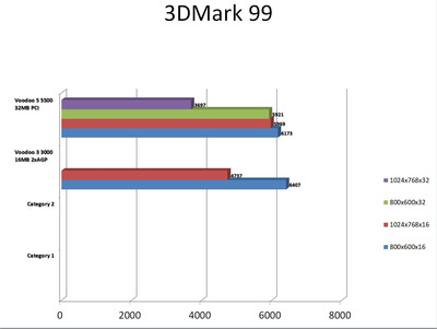

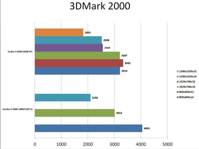

So I got my Voodoo 5 5500 PCI installed on my PIII 1Ghz/384MB RAM W98SE machine and it seems to run ok; but when I run 3dmark 2000 two tests fail and the first one is the CPU portion; 3d Mark2000 shows a red "benchmark cannot be run" message and moves on to the next portion of the benchmark. Anyone one have any idea what could be causing this? I tried setting the 3dFX control panel to DirectX and Glide alternatively, but that did not help.

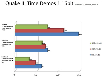

Reply 1 of 7, by Bohemond1099

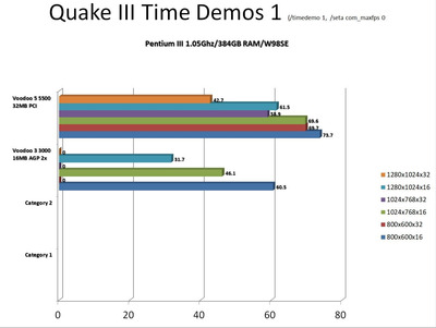

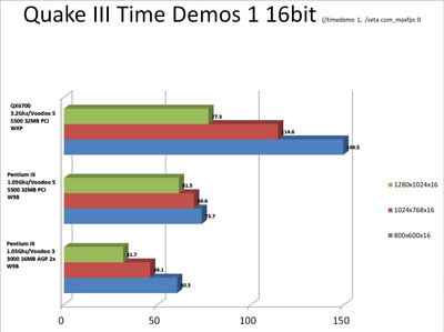

Update with what I find to be some interesting results; some reeaaly sluggish performance out of the Voodoo 5 55oo PCI; so thought I'd pop in my Voodoo 3 3000 AGP and see how the smoothness compared. It's night and day; even with lower average FPS the Voodoo 3 3000 is a smooth experience vs the stop motion the V5 5500 PCI gets in Unreal/Delta Force/Quake 3 (though interestingly Quake II and Dark Forces 2: Jedi Knight run great on the Voodoo 5 PCI). The constant slow downs I got in Delta Force, Quake III, and Unreal are gone. Thought I would post the results as well to see if anyone 99knows if this is the card or something else going on.

    Quake III TD2

    3DMark 99

    3DMark 2000

Doesn't help with the PCI question except for maybe comparison, I get 5526 3dMarks in 3DMark2000 @ 1024x768x16 with a 5500AGP.
At 1024x768x32 I got 3989.
I just realized you are running a P3-1ghz. That could be your limiting factor right there.

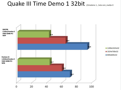

Reply 5 of 7, by Bohemond1099

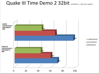

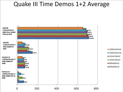

Ok got an update; I FINALLY got the Voodoo 5 to work with Amigamerlin drivers on my QX6700 system with Windows XP 32bit; could not get the Vcontrol utility to install though; exe just pops up real fast and then disappears without installing anything.

Reply 6 of 7, by Bohemond1099
Really too bad those AmigaMerlin drivers (3.1) only worked with Idtech games; would not run any DX8 games at all. Attempted the SFFT or whatever drivers; big mistake as usual; the previous Amiga was an unuseable mess that either crashed instantly or shot out polygons everywhere...so bad.
