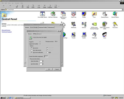

Reply 12 of 17, by Repo Man11
Assuming these games need to access the CDROM during play - is DMA enabled on the DVDRW?
"A lot of times when you first start out on a project you think, This is never going to be finished. But then it is, and you think, Wow, it wasn't even worth it." - Jack Handey

Reply 16 of 17, by johnvosh
Repo Man11 wrote on 2022-03-27, 23:29:
I can't enable it on the DVD drive as that option is not available. It is running on the SATA port.
Sys1: A64 X2 4400+, 2GB DDR400, 150GB WD Velociraptor, Radeon HD 3650 512MG AGP, MSI K8N Neo2 Platinum, XP Home
Sys2:
Sys3:
Reply 17 of 17, by Repo Man11
johnvosh wrote on 2022-03-28, 01:01:
I have (mercifully) little experience with ME, but doesn't it also have the tabs in Device Manager like 98 SE does? The DVDRW in my i875 machine (currently running Win98 SE) uses the SATA port, and DMA isn't enabled by default.
