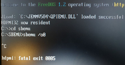

I tried the Jemm v5.84pre2 with dload and everything. However SBEMU still does not work. Through the headphones I hear a sort of initialisation tick and then the system becomes unresponsive (I cannot even restart with CTRL-ALT-DEL but have to use the power button). I then removed the /o0 to default to speakers with no luck.
I left it for almost a minute to give it some time and then pressed CTRL-C a couple of times to get the following:
99.03 KiB
456 views
Jemm v5.84 Pre Release - SBEMU Issue
With VSBHDA, the behaviour is normal like before in the sense that everything seems to load fine and gives no error but I hear no sound.
Any other suggestions are welcome. In the meantime, I will continue to test. Thanks
Robert

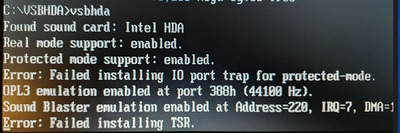

@digger - Using the Jemm v5.84pre2, now not even VSBHDA works as shown below.
82.1 KiB
346 views
Your feedback is appreciated.
