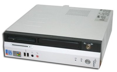

Reply 238 of 487, by dr.zeissler
ESS-SOLO1 WDM Win98 drivers do have some problems with specific games.
Unreal and expendable have crackeling sounds...do not have fixed this yet.
Perhaps I go for an YMH744 in that D1644 i865g-Chipset. (FSC C610 MicroDesktop 2xPCI)
Btw. i845gv has issues with flashlights in SOF1, i865g does not. Performance is much better. Now gaming in 1024x768 is possible. (i845 800x600)
    15.18 KiB
    1491 views
