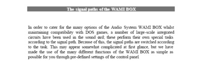

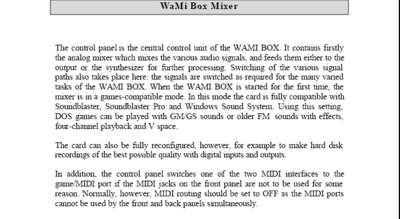

cyclone3d wrote:
I've just browsed through the whole paper manual. The WAMI-Box hos no DOS support. I'm not sure why the first page of this thread lists it as having Sound Blaster/Pro/WSS support. The manual has no mention of it at all.
It's a direct quote from the manual on the first page of the thread.
Page 11:
28.22 KiB
2892 views
And page 19:
14.8 KiB
2892 views
Reply 126 of 579, by cyclone3d
lolo799 wrote:
It's a direct quote from the manual on the first page of the thread. Page 11: […]
Page 11:
And page 19:
Ah, ok. I was reading through the original paper manual that came with mine. It is completely different then the downloadable one. My paper manual only has 20 pages not including the index.
I wonder if there are different versions of the PCMCIA card and/or the box itself. Or maybe the DOS sound support in Win9x really just doesn't work. I'll have to test on my end when I get a chance.

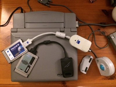

Hi there. I'm new to the forum and this is my first post here. Yet I've been reading many topics occasionally as I take some interest in old Thinkpads.
I'd like to share some info about 2 sound cards I've recently obtained. As far as I undersatnd it's actually the same card and they are in turn are the analogue of IBM 16-Bit Audio Adapter.
Here are the drivers that I'm going to check with the cards.
audio161.exe
audio162.exe
audio163.exe
audio16.txt
and here are some pics
PS
As I don't have the ability to PM yet, I'll put a small note here.
These are not analogues of IBM 3D Sound Adapter but of it's predecessor - 16 bit Audio Adapter. And the cards are not for sale, sorry.

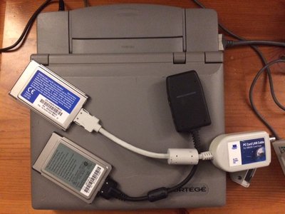

Reply 138 of 579, by mikeyp
lolo799 wrote:
No it's not the IBM 3D Sound card, it's a clone of the IBM Audio Adapter, like the Digital card shown at PCMCIA Sound Cards
Here are the drivers for DOS/Win3.x, OS/2 and Win95:
The attachment ibm pcmcia audio drivers.rar is no longer available
Thank you. That does indeed look to be the correct driver. cyclone3d also found the actual DELL drivers and posted links in my thread here: Re: PCMCIA in Windows 3.1 Honestly is was that long ago I first asked, I forgot I'd asked in this thread but it took me that long to get this machine up and running.
Bondi wrote:
Looks like this card was produced (or sold?) by all and sundry. Someone mentioned in this topic that got this card with Dell label on it 😀
I did indeed get it Dell branded.
107.63 KiB
2569 views
106.22 KiB
2569 views
