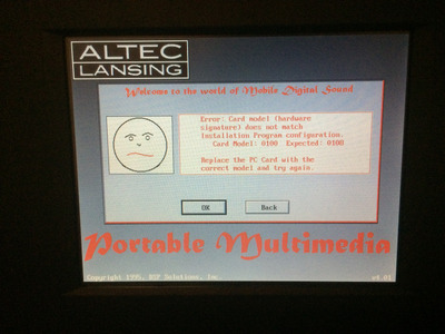

Reply 246 of 579, by Bondi
cyclone3d wrote on 2020-07-27, 23:12:
Only the CD drive itself has arrived. Still waiting on the other parts to get here from Canada... Yay for slow shipping.
In the meanwhile I found a copy of Sony Soundbox for myself and received it already. I'm glad to report that it's indeed working with Altec drivers.
The installation did not go through due to the card ID check. But installing the drivers manually, i.e. adding a string to config.sys and autoexec.bat (according to the link to toshiba website above, amending the names to "altec" where necessary) did the trick. SB emulatoin is activated by loading dsmaster.exe file. Overall all worked easily without any issues.
1.39 MiB
1596 views
In Wolf3d both digital and FM work fine, and sound pretty clean. In Doon there is only music, as expected. FM emulation quality is acceptable, will do some recordings later. The built-in speaker also works, but I'd prefer that it was louder. As for the joystick, I haven't tested it yet.

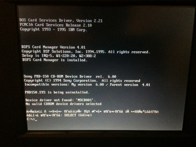

Reply 253 of 579, by Bondi
Here is the recording of FM synth on DSP Solutions/Sony sound box.
E1M1DSP.mp3
2.52 MiB
64 downloads
Obligatory E1M1
The CD part unfortunately did not work (in DOS). None of the drivers work, neither the one that comes with Altec, nor the PRD150.sys that comes in the W95 driver pack. Maybe cyclone3d will be more lucky with this.
1.21 MiB
1477 views
Also forgot to mention that I had to change HwSigAahh parameter to 0100 in altec.ini file to make the card work.

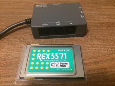

Reply 254 of 579, by Bondi
Got this card recently.
1.16 MiB
1468 views
Rex-5571
The drivers for DOS are nowhere to be found online. Only W95. Does anyone happen to have them? I'b be very grateful!
Also does anyone know whether MIDI (MPU-401) port on this card works in DOS? The manual mentions this switch:
/ Index22
This is the specification when using MIDI. If you specify this, you cannot specify "/ AdLib" or "/ Adjoy".
But you never know if it works in pure DOS or intended for W311.

Reply 255 of 579, by cyclone3d
Bondi wrote on 2020-09-08, 15:40:
Here is the recording of FM synth on DSP Solutions/Sony sound box. E1M1DSP.mp3 The CD part unfortunately did not work (in DOS). […]
E1M1DSP.mp3
Look at the readme for the PRD-155 driver set. Looks like another driver may need to be loaded first?

Reply 256 of 579, by bjwil1991
Perhaps the PCMCIA TSR drivers? My Toshiba T4800CT does the same thing with my PCMCIA 24x CD-ROM drive with the PCMCIA TSR drivers loaded after the CD-ROM drivers.
Reply 257 of 579, by MAZter
Bondi wrote on 2020-09-10, 07:56:
from manual:
<< Restrictions >>
-When operating a game for MS-DOS in DOS mode of Windows 95, the card does not operate normally.
The REX-5571/9871/4871 series has the following two models.
■ REX-5571/9871/4871
Floppy for models compatible with DOS/Windows 3.1 and Windows 95, Windows NT 4.0
Will attach 3 sheets.
・Windows 95, Windows NT4.0 compatible software floppy (this floppy)
・Windows 95/NT compatible audio application floppy
・Software floppy for DOS/Windows 3.1
■ REX-5571W/9871W/4871W
For Windows 95, Windows NT4.0 model, 2 floppies are attached.
From the previous REX-5571/9871/4871 driver audio driver for DOS/Windows 3.1
Except for the manual and manual.
So probably your model is only for W95 🙁

Reply 258 of 579, by Bondi
MAZter wrote on 2020-09-10, 16:30:
from manual: << Restrictions >> -When operating a game for MS-DOS in DOS mode of Windows 95, the card does not operate normall […]
from manual:
<< Restrictions >>
As I understood the 5571W model just does not include DOS drivers. Hardware-wise it should be the same card.
MIDI indeed is not supposed to work in W95 DOS session. But what about pure DOS? It's not quite clear from the manual.
Let alone that that there are no DOS drivers around. Maybe drivers for 5572 will fit? I have to try it.
PCMCIA Sound Cards chart
archive.org: PCMCIA software, manuals, drivers
Reply 259 of 579, by pool7
The first post of this thread mentions 5571 = 5570 + joystick port. There's also mentions that 5571 = 4871/9871. Have you tried the drivers for these?
Also, found a link that may be of interest hopefully: http://www.win3x.org/win3board/viewtopic.php? … tyle=30&t=19261
Good luck! 😀
PS: For reference, the japanese manual (couldn't find an english one) for the 5571 mentions the following files in its DOS section; however I couldn't find anything else about these:
REX5571.SYS
REX71DBK.SYS
REX71365.SYS
REX9871.SYS
REX4871.SYS
