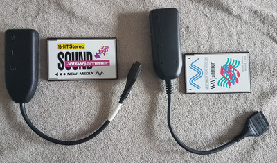

Which one Wavjammer is better? 😀
The dongle from the right side is slightly better made I think. Product number (of dongle) is lower.
I will have for exchange the one card if someone will need it.

One of them is maybe compatible with Windows NT 4.0.
Excerpt from the latest drivers:
1. How to check the version of your .WAVjammer
The .WAVjammer drivers for Windows NT work only with Revision F of the
.WAVjammer. To find out the revision of your .WAVjammer:
A. Boot your system with the .WAVjammer already inserted.
B. Copy PCMCMD.EXE from the Windows NT Workstation CD-ROM Disk to your
hard disk. PCMCMD.EXE is located in the \SUPPORT\DEBUG\I386 directory.
C. From the Windows NT command prompt, type:
PCMCMD > PCCARD.TXT
D. Using a text editor like Notepad, view PCCARD.TXT
E. Scroll down in PCCARD.TXT until you see the information related to the
CISTPL_VERS_1 Tuple. An example is shown below:
< Begin excerpt from sample PCCARD.TXT >
Tuple Code CISTPL_VERS_1 15 - Link 24:
4 1 4e 65 77 20 4d 65 64 69 61 20 43 6f 72 70
6f 72 61 74 69 6f 6e 0 2e 57 41 56 6a 61 6d 6d
65 72 0 ff
Manufacturer: New Media Corporation
Product Name: .WAVjammer
CRC: 4cd1
Product Info: ff 20 5 57
< End excerpt from sample PCCARD.TXT >
* For a Rev F .WAVjammer, the CRC should be 4CD1. If the CRC is not 4CD1, *
* the .WAVjammer is not a Rev F .WAVjammer, and will not work with Windows NT. *

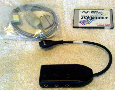

The card I owned years ago had a different sticker:

Oh wow, you have two of them, and you're willing to part with one? 🙂
I hope someone here who's tech-savvy enough could use one of these specimens to clone it. The cool thing about the Wavjammer is that it has native support in some (later) DOS games.
Anybody?
