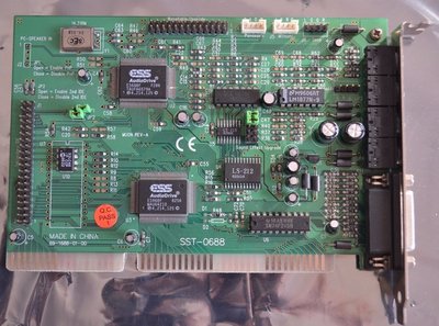

Reply 112 of 314, by JSO
My 688F is on the attached photo and has many jumpers! And CD-ROM works perfectly on the 386 build!
My 1868F also has some jumpers.
It's the same with the picture, but absolutely brilliant sound comparing to the SB 64 PCI (ES1370) I previously owned!

Reply 113 of 314, by tpowell.ca
Damn you Compaq!!
They must have their own version of software to drive this card...which I don't have. 😢
Are you using the same drivers as the ones posted here on Vogons?
http://www.vogonsdrivers.com/getfile.php?file … 372&menustate=0

Reply 115 of 314, by Ozzuneoj
That LS-212 chip sure looks a lot like a YMF262. 😀
