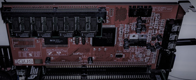

Finally done, so much trouble with solder paste, broken amp chip, weird software setup, but I am happy with the end result.
I am really surprised by sound quality of this, the clarity beats classic GUS, AWE32 and all software trackers I've tried so far.
A recorded tune is attached.

Feels great to have finished such a project on your own doesn't it? Being able to solder (smaller) SMD also is a great skill to have 😀
Glad you're happy with the outcome of this project.

terryfi wrote on 2022-06-22, 04:08:
Great work!
Just curious, but what did you use for a bracket?

Shponglefan wrote on 2022-06-22, 12:35:
Great work!
Used one from Sound Blaster 16 Vibra CT4170, it is a perfect fit.

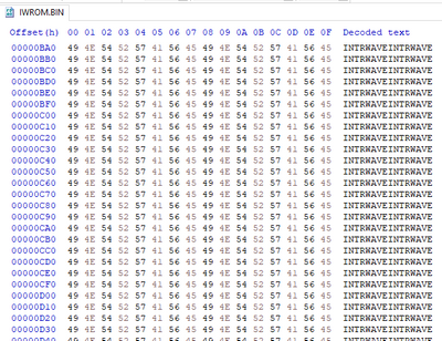

I am having issues dumping iw rom, the content are corrupted repeating part of header, most time repeating corruption is different effect and once in a while they look similar. Anyone?
Is there anyway to test iw rom functionality, e.g. play midi with rom patch, without dumping?

terryfi wrote on 2022-06-23, 15:24:
To make trouble-shooting easier, this assumes that you are in a pure DOS environment.
We will be able to get a better idea of what is going on if you post your IW.INI and the full output from IWINIT (type IWINIT -v9 > iwinit.txt, then post the files; it is important that 'v' in "v9" be lowercase). It would also be helpful, if you want us to be able to help, if you would post a clear, well-lit picture of the ROM area, including the configuration resistors and latches (naturally, without the SIMM in the way).
The most telling indicator of whether the ROM will be usable is the presence of a line beginning with "Found ROM chip:" in the output from IWINIT. If you don't see such a line, then nothing you try will get it to use that instrument bank, and it's back to the soldering iron. If you're using the dumping tool as per shock__'s instructions, and that is the result that you're getting, then the most likely culprits are that the ROM IC itself is not soldered down correctly/firmly, or the same is true of the latches. If you're getting that repeating pattern, the data and control lines would appear to be functional, and a problem with the connection to the address bus seems the likely problem.
Make sure you have the right parts for the latches, and start by re-flowing just those (non-conductive flux is your friend), then try again. If you're still not having any luck, try the ROM chip, while also making a particular effort not to over-heat anything.
If, by some chance, you do see a "Found ROM chip:" line, and it is correct, then you can try using PLAY.EXE to play any MIDI file. There, too, consider posting a sample of the audio output and any messages it displays.
Trying to validate ROM functionality by playing a file is not exhaustive proof that the ROM is fully accessible and valid. The method shock__ described is a good way to know for sure. Once you get the answer you are looking for the first time, try it a few more times to ensure that it is repeatable.
One of the latch chips was dead cold, found cold solder joint on vcc of that, tried again same issue, re-soldered all pins of both latches and IW chip issue fixed.
Maybe I should have wasted a lot of wick removing the solder from all pretinned pads, I think it would be agood idea at least for the ICs; with that pretinning it is very hard to have all pins flush to board.
BTW apparently I did not press submit for this reply, meanwhile 640k explained the issue, thanks 640k issue was exactly the connections.

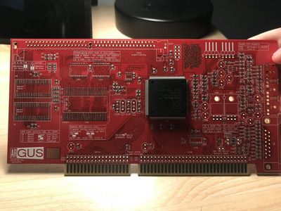

I'm almost done soldering mine but I have a question about x1 and x2. Is x2 mic in and x1 line in? So same order as real GUS PnP? I have color connectors so I want to be sure before testing it.
Reply 3018 of 3155, by terryfi
aitotat wrote on 2022-06-29, 09:33:
Based on schematic, from top to bottom on latest board, LINE, MIC and OUT.
