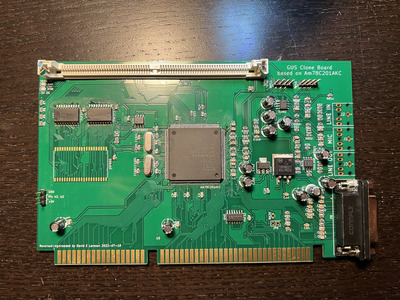

Reply 3083 of 3168, by kdehl
Hi!
I just soldered a few of my own reverse-engineered boards that I posted about months ago (more like a year, actually). Someone posted pictures of a board (GUSar?), and I went full retard and reverse-engineered and fixed it up a bit. Some address pins of the SIMM were switched and some other details that I can't remember right now.
So if I get this right, my version is a reverse-engineered version of the the GUSar which was a reverse-engineered version of ARGus, which is a reverse-engineered version of some board AMD did, which in turn is a reverse-engineered version of Gravis' boards?
Only problem is that I didn't have any 72-pin SIMM modules to test the boards with... 😒
Seriously. What kind of retro-computer nerd does not have 72-pin SIMMs at home? Embarrassing.
Anyway, friends to the rescue. I will go and pick up a few tomorrow evening and continue the testing later during the week.

Reply 3084 of 3168, by elfoam
Nice one, yeah I posted photos of the gusar, you should have mentioned you were using those as I scanned the boards better later on. Seems like you figured it out anyway despite the blurriness, well done.
Reply 3085 of 3168, by kdehl
Yeah, it worked out. 😀
Just tested one board with a SIMM and it worked well with Pinball Fantasies:
https://nygatan.dose.se/~madman/files/gus_pinball.mp4
All I had time to test tonight.
Anyway, I will put them up for sale when I have ordered more. The five I had were sold out in an instant in a Facebook group. 😀

Thank you for the kind words. 😀
Yeah I had to switch out quite a few components. The most obvious might be one of the voltage regulators. They don’t look symmetric anymore unfortunately. But they work.
Yeah let’s pretend that was a joke and not a typo! 😀
