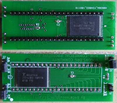

Firstly, I thought some of you might like to see a slightly clearer picture of the ROM module:
931.07 KiB
502 views
