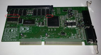

Reply 980 of 3174, by shock__
I've looked into the 4MB ROM approach once again ... case in point, anyone up to soldering TSOP48 with a pitch 1.5x as fine as the InterWave? 😀 This certainly is overkill for the average hobbyist and something I'd have to teach myself first.
After checking into it various times I think now is the point where I can definitely postpone that idea due to a number of reasons.
- There is no 4MB ROMset known to exist
- The ROMMaker included in the InterWave SDK is an older version
- The 4MB ROM would have to be hardcoded in the GUS PnP drivers to be useable - considering the drivers in the InterWave SDK on the internet are outdated this could lead to a number of issues. An alternative approach would be hacking the existing GUS PnP drivers - something I cannot do or teach myself in a sufficient time.
- I'm unsure about the actual implementation in hardware (very likely via the RA20 + RA21 lines, but I could be wrong)
- Suitable ROM ICs are only available in packages I don't consider hobbyist friendly (and not that easy to obtain either)
- Adding a footprint for 32mbit ROM ICs would require rerouting a majority of the layout left to the InterWave chip, the general area where I spent 60% of the time for the project on.
I think I'll instead look at a way to make the current 1MB ROM flashable in circuit instead (which is just an idea for now - not a feature announcement) 😉
On the other hand I'm currently adapting the layout a bit to accept SOJ-sockets for the DRAM, making the card a bit more user serviceable and giving it a bit more professional look (afterall one of those DRAMs was dead on the prototype).
Also: ISA faceplate 😀 http://i.imgur.com/WPE2PN3.jpg

Reply 981 of 3174, by kmadar75
Is there enough space between the top of the ram and the ICs ?
I mean if you have a bigger module in height or you put a slot for DRAM.

Reply 985 of 3174, by shock__
kmadar75 wrote:
Is there enough space between the top of the ram and the ICs ? I mean if you have a bigger module in height or you put a slot fo […]
Anyway the fact it is working is freaking awesome. Hats off shock.
Clearances should be fine even when using double sided SIMMs. I strongly recommend getting single sided ones to prevent any potential issues - as I can test every type of SIMM on the market.

Small update:
Shock visited me yesterday and brought the ARGUS prototype for testing.
It was equipped with a 16 MB PS/2 SIMM and the 1 MB ROM.
It passed:
- IWINIT detection (incl. RAM size) and initialisation (2.23)
- IWEPROM readout and writing
- Tracker players with support for Interwave and large songs. (XTC, OCP), incl. memory bank mapping and effects
- Megaem 3.11 functionality
- Win9x PnP detection as well as Win9x driver installation
- playback test within Win9x for digital and Midi from ROM and RAM soundfonts
- Mixer operation in DOS and Win
- Line-In, Mic-In functionality, there seems to an echo effect on Line In, we could not find out why the card applies this by default (e.g. in DOS)
- subjective Audio quality judgement is good, better than the regular GUS PnP Pro. The card sounds clean. We did not measure exact noise floor values yet.
- We tested a bunch of PS/2 SIMMs of various sizes. The card does take about 90% of the SIMMs without issues. It doesn't cope with any memory layout, so some SIMMs will be detected at 1/2 or 1/4 capacity. We couldn't find very slow PS/2 SIMMs for testing. One were not detected at all and got slowly hot. Still I consider this as 'working'.
- A few issues were found with placement of the jumpers that larger double sided SIMMs won't fit. However a minor placement change of a few components were already in the queue before...
Here are two pics of the ARGUS prototype in my testbench (P3 800):
http://retronn.de/ftp/pictures/hardware/ARGUS … est_setup_1.jpg
http://retronn.de/ftp/pictures/hardware/ARGUS … est_setup_2.jpg
We did not test the -5 V ISA bus voltage feature.
Also IWSBOS in DOS was not tested. I will do this probably later, but my general recommendation is to get a real SB compatible card if you need this.
Regards, Shock and Me.
