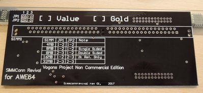

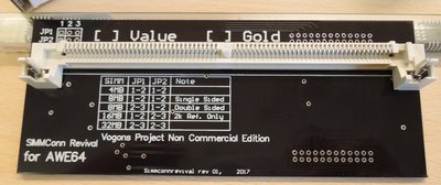

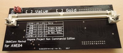

Hi,
no need for altium files at this moment.
Still waiting for some components to arrive, and PALCE programming to do,
but already I can tell, the proto PCB looks great (arrived today), and the 20 deg. SIMM connector fits well.

Reply 181 of 550, by hard1k
I guess the SIMM will still obstruct the adjacent card.
Only the 90 deg sockets would do - or merely placing the RAM chips onboard as suggested earlier in this thread, but most people want the SIMM for some reason.

Reply 184 of 550, by betamax80
From what I gather from Serge guys it's down to parts cost and availability, as well as the amount of modification required. Remember that at this stage, without Xu's approval otherwise, it can only be a "community project" not a commercial product. I also know that Serge obtained the 90deg. connectors (that's the flat-to-pcb type right?) and they appear to match this pinout.
There has been trouble tracking down the PAL chips so everyone keep an eye out for those, it seems that later versions require substantial PCB reworks as well. There are a couple of missing puzzle-pieces already (apparently something is not compiling quite right in the GAL code by 1 bit) and just to make a modern-day (as in parts) replica is taking time.
I think Serdaco is being fab to take this project on and honestly I'd take the board in any format, over paying £xxx for an original or CT1950 on ebay. That just isn't funny.

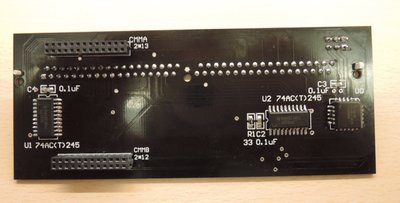

Reply 187 of 550, by dreamblaster
Hey guys,
small update, board completely assembled,
PALCE programmed with the original VALUE jedec (gives a warning).
110.7 KiB
1356 views
97.81 KiB
1356 views
Not sure if it will work, will send this to a vogons friend for testing 😉

Reply 188 of 550, by dreamblaster
Currently using this SIMM connector. this is a 22 degrees version :
http://www.mouser.be/ProductDetail/TE-Connect … -AMP/5822134-3/
5.69 euro + VAT per piece (when buying 10 pieces)
These are the 2 'flat' alternatives I found at mouser :
http://www.mouser.be/ProductDetail/TE-Connect … AMP/7-5382486-2
11.34 Euro + VAT per piece (when buying 10 pieces)
http://www.mouser.be/ProductDetail/TE-Connect … MP/7-5382487-2/
23.65 Euro + VAT per piece (when buying 10 pieces)
I think by now, I can get to all parts needed.
if there's really a strong interest in the flat connector I can order flat ones too,
to try out, but let's first wait if the prototype works as it is.

Reply 192 of 550, by SIMMConn
Don't waste your money on the right-angle SIMM socket. They look neat but are still too tall (will conflict with card in the next slot). IMHO you shouldn't even spend money on any new SIMM slot. They should be quite cheap and abundant in the surplus market, something like $0.50 each.

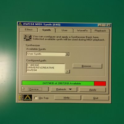

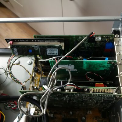

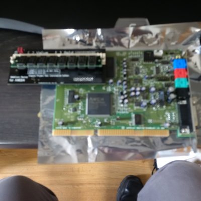

It works guys!!!! Took 3 different sticks to find a compatible SIMM but I have one.
Even though it's a "Value" I have 28mb available! Very cool, perhaps a code fix?
Actually I have a request guys - does anyone have AweVBank 98 or the "SFmaxx" that was supposed to follow? I found an old (1995) version on an AWE32 "The Musicians Guide" book companion CD but none of the download links work from archive.org (filename is supposed to be AweVBank98Install.exe)
I now intend to try previously recommended 28mb SF2 fonts:
GeneralUser GS v1.35: http://www.schristiancollins.com/generaluser.php
And possibly Chorium A (but people are saying the E-MU 8000 is not reading it properly).
Looking for a "smarter" utility to manage the soundfonts on board.
