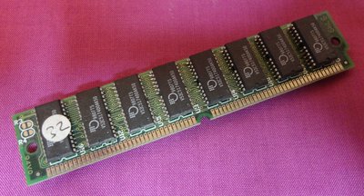

Once I replace a Parity SIMM I purchased by mistake with a non-Parity SIMM it seems to work just fine. Have a universal in a AWE 64 Value Edition. Still trying to figure out how to connect my front panel headphone & microphone jacks up, but the RAM works fine 😀
The SIMM I used is just a generic 32MB 72-Pin 60ns EDO SIMM Non-Parity Memory RAM 16-Chip Apple Macintosh PC UNIX. Chosen because it was inexpensive and in the US and not in Europe. There are no other markings or identifiers on mine other than the label shown in the picture.

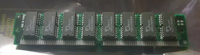

Been meaning to test with a couple more memory modules since I've already had these for months now, but Serge's Universal (JP1 2-3, JP2 2-3) and Gold (JP1 p3-JP2 p3) have both worked fine with the 32MB module I have used, on my CT4390.
Mosel Vitelic V53C517400AK50 based (non-EDO, 5V rated, 2K refresh), non-parity.
380.84 KiB
2566 views
Just now, I gave the EDO version of the same (V53C517405AK50) a go, and no problems there either.
196.94 KiB
2559 views
