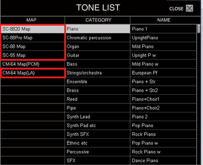

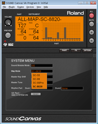

Reply 207 of 745, by Roland User
This a separate file , but I'm on the regime in the SCVA )
After all, CM-64 there is in maps ) why this mode absent in mode list ?
Where to get GS Advanced Editor ? This Software It comes complete with SoundCanvas SC-D70 )
James-F
I mean it
But that interested , why maps limited SC-8820 ? Why not SC-8850 ? How to learn this ?
Also interesting , what is CM-64 PCM Map ? And Why in this mode so many duplicate ? Example Piano2 or Slap Bass 1 or any other instrument.

Reply 208 of 745, by James-F
I just checked the SC-8820 manual.
SC-VA is like SC-8820, you can't actually select CM-64 Map from the panel (it has no buttons) like in previous models.
You have to activate it with a special midi file (my previous post).
As for the GS Advanced Editor, I can't find it either.
Reply 210 of 745, by James-F
Yes, but I'm not the address for feature requests, I think I made that clear.
CM-64 can be accessed with CC00=126 and CC00=127 (bank) then just switch the patch to 1-127.
This is done when you compose music in your DAW.
Or use the MT32 Midi file to switch to CM-64 mode before you play a MT-32 game.
Use MUNT for that, you don't need CM-64, give it a rest buddy.

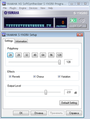

Of the requests could want in the settings SC-VA volume gain... e.g. such values from -12 dB to +12 dB in global volume. This need because often be quiet sound in compare with other synthesizers.
Using VST Host uncomfortably , SAVIHost comfortably , but not have amp volume

Reply 214 of 745, by James-F
Roland User wrote:
All the same, bug detected ) yes , only just in GM mode ) error with drum select ) when use GM mode , must have only Standard Drum kit.
https://temp-share.com/f/lcxfrhhpcl/2f3be25c4 … 62e3ed9f8ececa0
The General MIDI Standard drum kit. The only kit specified by General MIDI Level 1.
Although games like Duke Nukem 3D uses Power kit, or Warcraft uses Orchestra kit, it is not part of the General Midi 1 standard.
http://www.voidaudio.net/percussion.html
I don't see a problem.
The volume is purposely made quiet for SC-VA not to distort the audio when a lot of instrument play together.
On the contrary, it is a good sign that Roland knows what they are doing, I tell you that as a musician.
S-YXG50 for example will distort the sound if more than 3 instruments are playing together.
I set S-YXG50 to -10db output so that it matches SC-VA and does not distort the instruments.
Please read this post attentively, I know english is not your native language.
