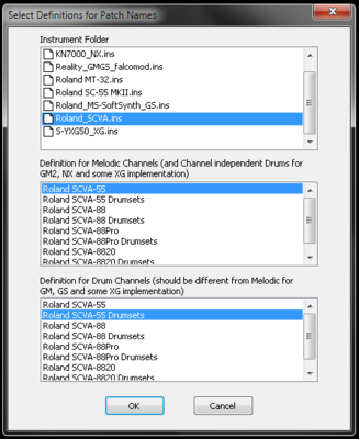

Fellow SC-VA/Synth users and MIDI music/game lovers, I'd like to point your attention to a great software called Falcosoft Soundfont Midi Player.
Official FSMP thread on Vogons: Falcosoft Soundfont Midi Player + Munt VSTi + BassMidi VSTi
This software is the most complete and fully implemented Midi Player and Instrument Mapper (input to output).
Many new features have been included in the new version, making FSMP the best midi player on the market.
The latest version supports Capital Tone Fallback feature using official instrument maps (customizable) to prevent wrong instrument variations
resulting in no sound or wrong sound with various synths including the SC-55 (hardware) or Microsoft softsynth GS.
Moreover, it includes Drum Patch Fallback (on any track) so it will always fallback to the next lowest correct drum patch from the wrong one.
You can play music written on a later model than SC-55 and have an equivalent capital tone instead of silence.
31.83 KiB
5997 views
Just assign FSMP Input Midi, Output Midi and Instrument Map, and you have a full solution to CTF with Music, Games, or any other input including real midi synths.
For example, you can route Dosbox through FSMP to SC-VA and have CTF without silent, incorrect instruments or drums in games that have composition errors or "lazy programming".
You can use you real retro PC and real SC-55 unit with a USB->MIDI dongle and a spare laptop running FSMP, or any combination of the above.
Help and support in the official FSMP thread.

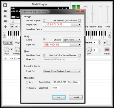

Nothing complicated at all.
Watch this "Roland MT-32 CM-32L and General MIDI for $50" video by PhilsComputerLab:
https://www.youtube.com/watch?v=nvuncHhza5A
To use with real retro PC and SC-55 hardware:
Instead of Midi-OX use Falcosoft Midi Player and set it's Midi-Input to your USB-MIDI IN and Midi-Output to your USB-MIDI OUT.
It even loads soundfonts using bassmidi so you save yet another software.
47.97 KiB
5892 views
Connect the USB-MIDI OUT to your SC-55 or any other midi synth.
To use CTF follow this step by step post (mainly step 3):
