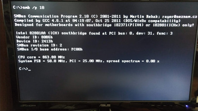

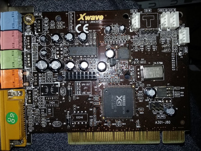

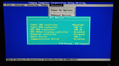

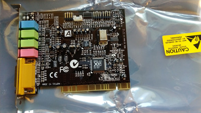

Reply 191 of 230, by enaiel
Hi, I'm hoping someone can help me, as I've hit a dead-end trying to get the YMF744 work on my P3 Retro DOS PC.
The YMF744 card is a brand new AOPEN AW744L II card. Pics of the box and card have been attached.
The PC is a Compaq Deskpro EXD P866, released in 2000. As per its Tech Reference Guide, it uses the i815 chipset and the 82801AA ICH southbridge. This has been verified using smb.exe /p 10. Output of this command is attached.
I have disabled practically everything in my BIOS. The YMF744 shows up as Audio Device using IRQ 5. Pic of this BIOS screen is attached.
I'm using the YMF744 driver package provided by @kalohimal, also attached.

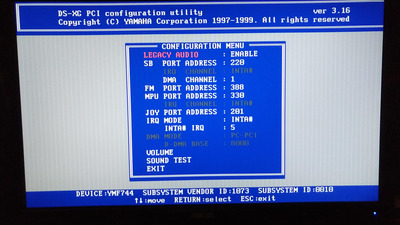

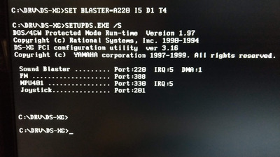

Reply 192 of 230, by enaiel

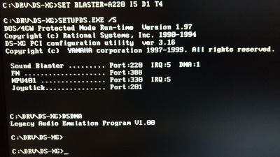

For the first test, since the motherboard has a 82801AA ICH southbridge, I tried to get it working using DDMA. So, I booted the PC and bypassed my config.sys and autoexec.bat, and ran the unmodded setupds.exe. The DS-XG PCI configuration utility screen pops up, but IRQ CHANNEL amd DMA MODE are disabled. If I try to run SOUND TEST, I get an error: Can not detect DMA at channel 1. The Sound Test pops up, but SOUND BLASTER 8BIT SOUND is disabled. FM SOUND and NATIVE AUDIO 16BIT SOUND work fine. If I try to exit and save, the same error from before popups up, and it doesn't let me save. A screenshot is attached.
So I try to force it by setting DMAMODE=1 in the DS.INI file, and running setupds.exe /s and setting the BLASTER variable. I have attached the output of the command. It looks fine, but besides FM I don't get any other audio. The DS.INI file is also attached.
    ds.ini
    327 Bytes
    13 downloads
    1.02 MiB
    373 views
    472.66 KiB
    373 views
DOS PC: Socket 370 / VIA C3 1.0 GHz / Voodoo2 + Trident Blade3D / SBPro + YMF744 + AWE64 + SC-7
Best DOS Games: CGW 150, PC Gamer 50, Worthwhile 100
Reply 193 of 230, by enaiel
For the second test, I tried to get it working using DSDMA. So, I booted the PC using HIMEM+EMM386(NOEMS), and set the DMAMODE=3 in the DS.INI file. Then I ran the unmodded setupds.exe /s and set the BLASTER variable. The output was exactly the same as before. Now I ran dsdma.exe, and the output looks fine (attached).
I still get only FM, but now when I try to run any audio program, they crash.
At this point, I have tried pretty much everything I can think of with no luck. Any suggestions will be most welcome.

Reply 194 of 230, by cyclone3d
1. You will have to use the modded setupds.exe. The different modded setupds.exe programs have the IDs for the different southbridges included (by replacing the ID of the southbridge in the original setupds.exe). Without that, DSDMA is the only way it will work and the compatibility is not going to be as good as with D-DMA.
2. You must run setupds.exe /s to initialize the card before running setupds.exe to go into the config GUI. Pretty sure the FM is the only thing that will work if you don't run setupds.exe /s first.
3. Editing the DMA in the DS.INI is not going to make it work. You need to find on in setupds.exe that works. I would try DMA 0 if 1 or 3 doesn't work.
4. The IRQ used for the Sound Blaster 8-bit sound is not necessarily going to be the same as what the BIOS detects the card at. I would try IRQ 7 and see if that helps if 5 doesn't work.
Edit: So the un-modified setupds is supposed to support the ICH (the one you have) according to the howto.txt in the driver pack you posted.
There also may be a newer stock setupds.exe. The one you were trying is 3.11 according to the RELEASE.txt file. I think there may be a version 3.12. Check the dsxgdos-DSDMA.exe from my google drive (link in sig).
If you still can't get it working, let me know and I will hook up a PIII 815i based setup to test on my end... pretty sure I have an 815i based board now.

Reply 195 of 230, by foil_fresh
i think the issue with enaiel's setup is that the usb controller is taking irq 11
the pci sound card must take irq 11, then the dsdma/setupds will use ddma to interact via irq 5 for the sb/sbpro data transfers. (i think this is how it works?)
but again i might have it wrong as your chipset is something i havent used yet. have a go and see if it helps.
Reply 196 of 230, by enaiel
@foil_fresh
I changed the USB IRQ to 9 and the YMF744 IRQ to 11 in the BIOS, but it did not make any difference when running dsdma.
@cyclone3d
I have tried setupds[1-5].exe and it did not make any difference either. I also tried running setupds /s first before running setupds, and the screen was the same as before.
I cannot select IRQ 7 in my BIOS, but changing the IRQ to 9,10 and 11 had no effect.
An update:
I do have sound with dsdma - the reason I though I didn't was around 80% of all my audio applications and games crashed after running dsdma. Turns out that DOOM still works and has audio! But nothing much else. I'm going to try your driver now to see if it makes a difference.
