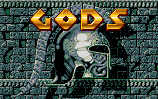

Hello everyone, I've done some more recordings.
For the game GODS, I used the SoundMachine, SoundBlaster 2.0 and the Protac card.
That ThunderBoard clone was already in the machine and so I thought it would be a good idea to do
a recording for comparison.
I also turned the volume knob a bit up for a better SNR, I hope I didn't overdrive the cards' amp. 😅
At least Audacity's input levels were on the safe side..
I also did another recording of the Protac card.
Previously, I had to use another test because MPXPlay thought it was a SB Pro..
This time I converted the wave and played it back using playfile.

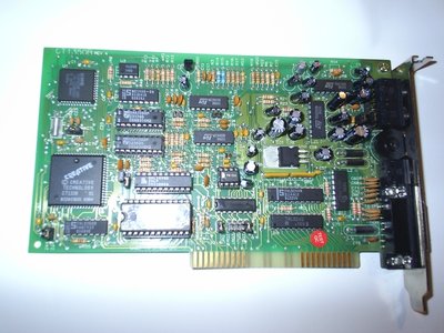

Reply 35 of 44, by Jo22
Good news!
I got the CMS upgrade working! 😁
I was very nervous to not to ruin my REV 4 card..:
It is the oldest SB2 I've got and I did a recap just recently.
Before the first try I even removed the YM3812 (FM1312) as a safety measure.
Besides, it was part of the bequest of one our families friend who passed away a few years ago.
A few weeks before he went, he also gave me his beloved C64 as a gift. He was such a nice person.
So when I got that card from his wife (among other geeky things) and repaired it (new voltage regulator),
I wanted to keep this one as a memento of him. Luckily, everything went fine this time.
I think he would be happy to see that his old "junk" wasn't just thrown away, but was helpful and brought
joy to other people. 😀
    136.22 KiB
    1956 views
    Creative SB 2.0, CT1350B REV 4 (recapped) with C/MS upgrade

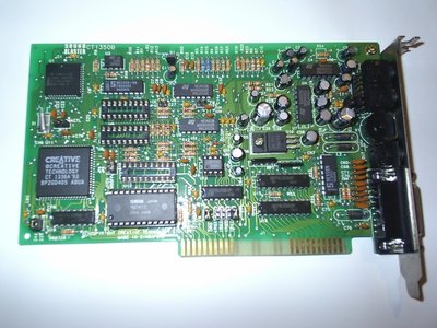

    144.84 KiB
    1956 views
    Creative SB 2.0, "SOUND BLASTER CT1350B", DSP v2.02, CT1336A, second card
