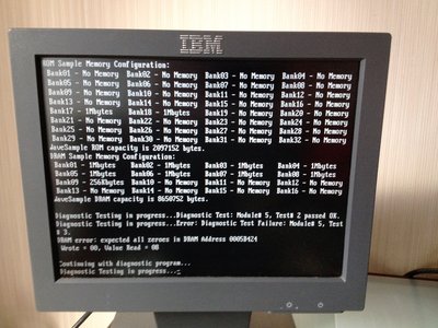

My Maui arrived. It works, but MAUIDIAG reports a memory test error when both RAM slots are populated on the card. With just one stick of RAM, dependless on the slot it is inserted into, no memory errors occur. Did you see anything like this, Fabian?

Reply 74 of 104, by FuzzyLogic
I too got a Maui recently and I installed two 4MB sticks of RAM. I just ran the diagnostics and the memory tests (module 5?) all passed, but took forever. Did you try two different sticks of RAM?
Reply 75 of 104, by bristlehog
Yes, I tried different sticks of RAM. No matter what stick I use, if I populate both RAM slots, errors occur. If I populate only one slot, dependless of which one, first or second, no errors occur.
Perhaps I'll try 1mb sticks instead of 4mb ones just for the sake of experiment.
It might be that my Maui is defective, despite being new and unopened before me.
Hardware comparisons and game system requirements: https://technical.city
Reply 79 of 104, by bristlehog
I don't see any passives in bad shape.
I tested with 1 Mb sticks, and everything works fine, except for 2x4 Mb configuration. 1 Mb, 2 Mb and 5 Mb of RAM work. But when I stick in the 8 Mb, there are memory errors when running MAUIDIAG.
Perhaps I should check another type 4 Mb sticks (I have 4 of them but all of same type), problem is that I don't have any currently.
