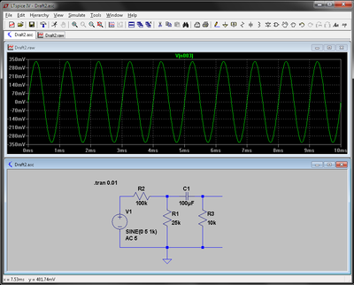

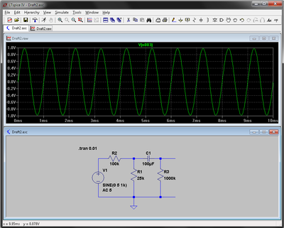

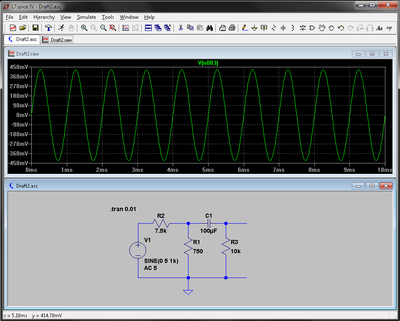

Consumer line level is 0.316V RMS or 0.447V Peak, so it is important to include the load resistance when measuring voltage.
If I include a 10k input impedance of a typical consumer device such as a sound-card line-in I get 0.350V peak, without it, the level is indeed 1V as MobyGamer measured.
The 100k/25k variation (as with the real Covox) is sensitive to input impedance, so if the input impedance is 1M the Covox output voltage will be 1V, but with 10k load the voltage is 0.350v.
With the 7.5k CVX-2 a 1k (or even 750ohm) resistor will be more appropriate since a 2k resistors reaches almost 1V which is almost twice the standard line level.
This variation is less sensitive to load impedance above 10k, and the output voltage will stay the same.
@MobyGamer, can you measure the Covox output again with a device (your recording computer) plugged into the Covox?

Reply 251 of 484, by Jepael
James-F: That's why I was more focused on getting the resistances identical, so that when connected to same equipment, they sound identical. Connecting 7k5 device and 100k device to same recording equipment will have different amplitude/frequency/lowpass characteristics as the source impedance is not identical. If you bring down the voltage on a 7k5 device with about 2k load resistor, you can always add series resistance to bring up the source impedance to match original 100k device source impedance. But I still don't know if they can sound identical, as the 7k5 network will load the data outputs more, so the voltage output of the ladder itself without any extra load resistors is lower anyway. The original LPT port had 5V LSTTL chips and they have quite a high output impedance when sourcing current (it could approach 1kohm). Modern LPT ports may have push-pull 3.3V CMOS outputs so output impedance should be safely below 100 ohms, and the voltage is definitely lower.
And about the line level, there is no formal specification what is the maximum. 1Vpp audio is just as good as 2Vpp audio, but 5Vpp starts to be too much. That -10dBV (0.447Vp) is only a typical level, it does not say anything about the maximum level. Even in the next wikipedia chapter they say line outputs could reach 2Vpp (=1Vp) even when loaded with 10k. Many line outputs are capable of providing 2Vrms at full scale (5.6Vpp) and many line inputs can accept it without clipping. You can measure yourself what your sound card outputs in typical environment, say playing your favourite music when connected to home stereo line input perhaps. And even in that case, playing full scale sine wave should be much louder than music.
In broadcast devices however, the alignment levels are standardized, and there are many standards - in some broadcasting studios the +4dBu (1.736Vpeak) alignment level is the analog output level when a -20dBFS digital tone is played, so that's not the maximum either.
