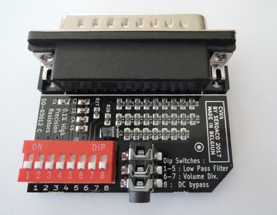

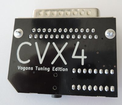

Hey,
a small update : I noticed I needed to swap 2 smd caps, to get all right filters :
The automated assembly had put 47nF and 100nF on there (my mistake in part nrs), but we need to do subtle filtering of course (exactly as tested)!
For the 6 units already shipped out : I will send you another CVX4 with corrected caps set, so you will receive 2 x CVX4 in total 😀.
All production boards will have the correct filter options, for tuning your sound to 8 bit perfection :
Dip switch legend for the production boards :
dips 1-5 : low pass filter
1: 1nF : significant low pass filter
2: 4.7nF : heavier low pass filter
3: 10 nF : very heavy low pass filter
4 : 0.1nF : very subtle low pass filter
5 : 0.47nF : subtle low pass filter
dip 6-7 : extra volume divider :
6 : 56k (1/2R)
7 : 27k (1/4R)
dip 8
8 : bypass coupling capacitor
Thanks for your support !
