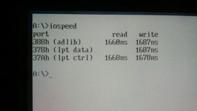

Matze79, can you run https://2k38.be/adlipt/iospeed.exe and report which numbers you get?
Possibly the ISA bus on your 286 runs faster than standard. That would cause compatibility problems with Adlib software.

Here my Machine:
https://dos-reloaded.de/forum/index.php/Threa … 12Mhz-Luggable/
And iospeed:
75.84 KiB
979 views
